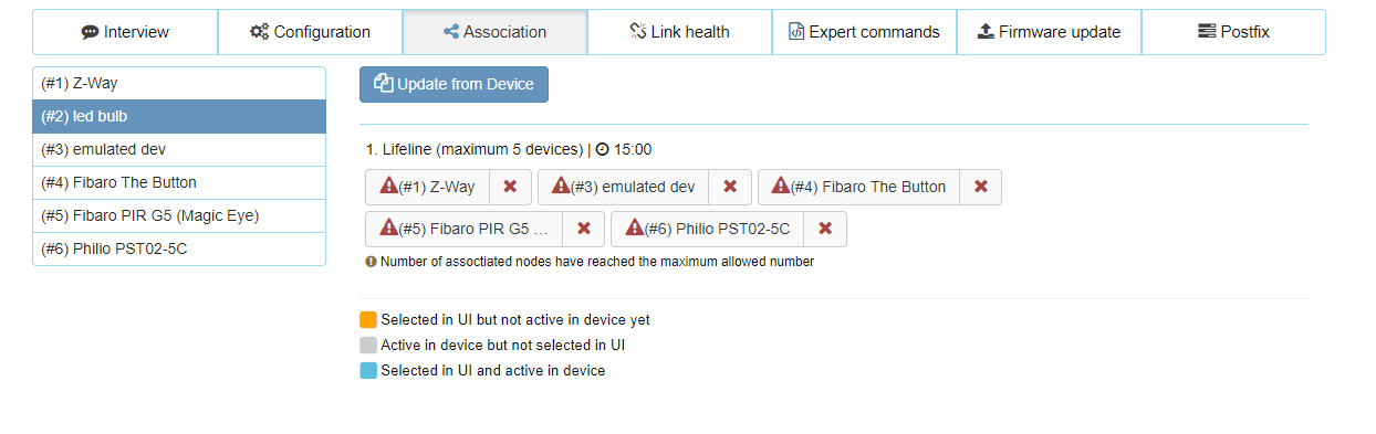

I tried to do this configuration:
attached
but I don't understand how it work.
Can anyone help me to figure out how it works and how to use in expert UI?

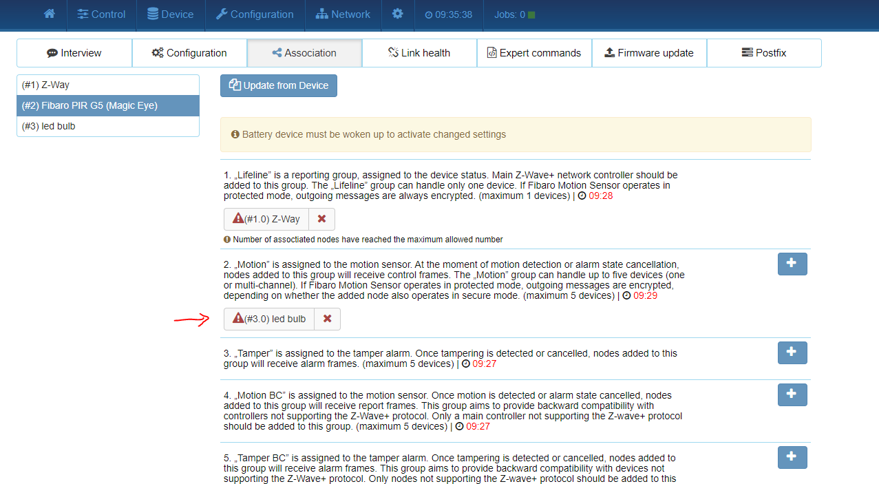

Now I have reset the controller and re-include only the fibaro "magic eyes" and the led bulb and I created an association.
but when the PIR sensor notice detects a movement the led bulb doesn't changes its state (remain off).
Do I have to do anything else?

Posted: 23 Aug 2017 19:26
by janjan
...the magic eye was awake between? just during a wake up sends the controller the association-info to the magic eye, after this , it should work
in your picture the red time-stamp seems to say the magic eye wasnt awake

by Andrea.Tringali
This configuration are working about two day and newer the led bulb turn on when the fibaro motion sensor detected a movement. So, I don't think that is a problem of wake-up .. :roll:
