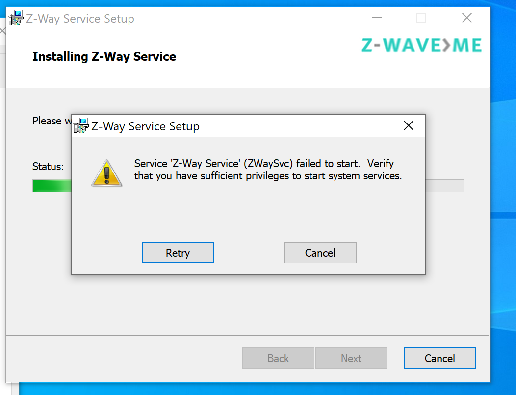

I have added a screenshot of the message, the install is run as administrator, but still it still failed to start the service, and therefor the only option is to cancel the installation.
For the PI, no i havent i jsut recently bought the zwave uzb stick. But i would like to have it running on a RPi

Posts: 7649
Re: Installation UZB1 on Raspbian or Windows 10
May be there is a log in the Z-Way folder (in Program Files x86). May be there is a clear error there.
Also have a look on your Firewall - may be it disallow opening ports
