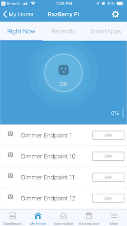

In my z-wave network, my RaZberry seems to advertise that it has 16 "Dimmer Endpoint" instances. I can see it if I use my SmartThings controller UI...
