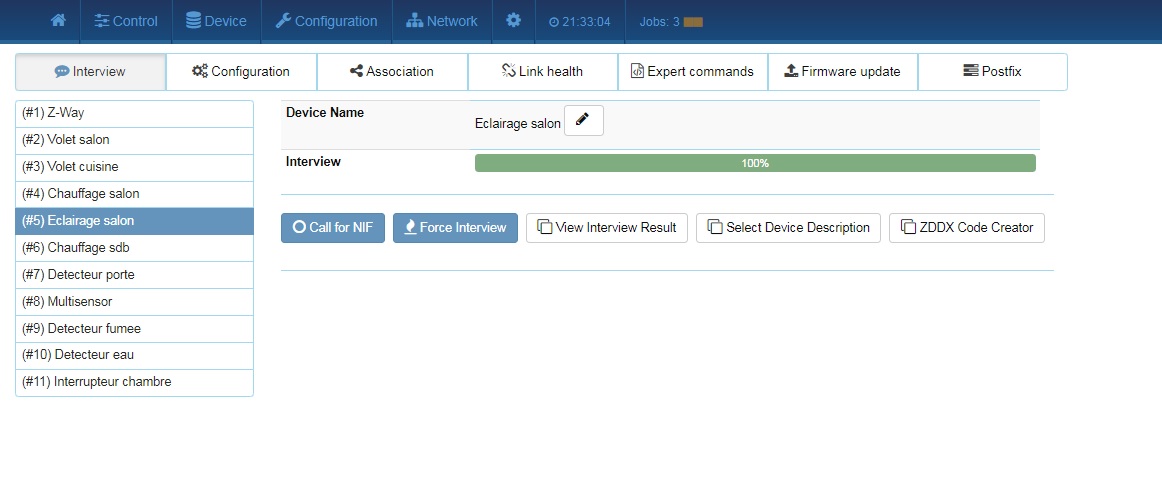

Everything works fine but since I upgraded to v3.0.0-rc16 nothing appears in the interview tab for these 3 devices.
Sans titre.jpg (95.65 KiB) Viewed 21996 times
