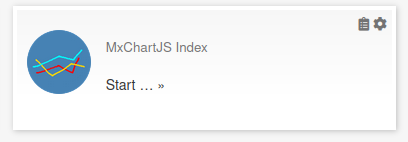

Bildschirmfoto vom 2021-02-07 13-27-51.png (10.99 KiB) Viewed 131931 times
Create a new instance of module Information Widget and enter following configuration (with some blanks after Start):
    moduleId: "InfoWidget",
    active: true,
    title: "MxChartJS Index",
    params: {
        widgets: [
                headline: "MxChartJS Index",
                text: "Start
                <script>
                    //target = '_parent';        //open in same window
                    target = '_blank';         //open in new window
                    window.open('user/MxChartJS/index.html', target);
                </script>",
                imgURI: "/ZAutomation/api/v1/load/modulemedia/MxChartJS/icon.png",
        internationalize: false
    creationTime: "2021-02-07 13:23:54",
    category: "device_enhancements",
Wih same method it's possible to call also other webpages like MxInfo Index or whathever you want.

Thanks, I already tried it before like this - but after closing the called page there will be the JS window still visible with the Start... , right?
I use iframe instead - it is working fine ;)

Hi Michael,
nice to get some response.
It's only a quick hack. I've tried to find an easy solution. Can you provide yours?
Here is my improved one, starts the index in new window and closes the modal:
    active: "true",
    title: "MxInfo + MxChartJS Index",
    params: {
        widgets: [
                headline: "MxInfo Index",
                text: "<title>Start</title>
                <script>
                    //refresh current window to close modal
                    window.location.reload();
                    //open index in new window
                    window.open('user/MxInfo/index.html', '_blank');
                </script>",
                imgURI: "/ZAutomation/api/v1/load/modulemedia/MxInfo/icon.png"
                <script>
                    window.open('user/MxChartJS/index.html', '_blank');
                </script>",
    creationTime: "2021-02-06 12:53:09",
It may be necessary to enable popups for that page.

I have used the most easy version :D
<iframe src="user/MxChartJS/index.html" style="border:none;height:580px !important" width="90%" title=graph"">
</iframe>

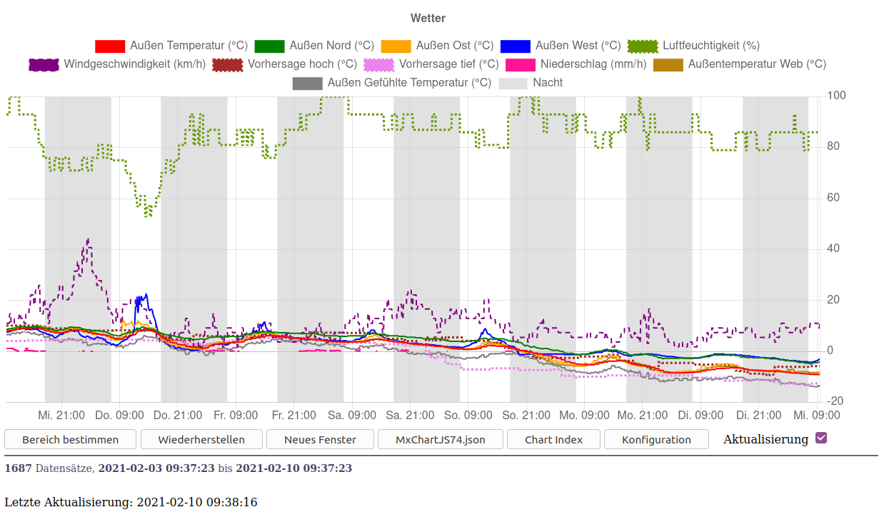

Re: MxChartJS tip: conditional coloring the background
Posted: 10 Feb 2021 14:45
by piet66
Although it is not intended, with an additional entry you can colorize the background:
    index: 12,
    device: "Daylight_35 (Tageslicht)",
    metric: "level",
    formula: "x == 'off' ? 100 : null",
    devlabel: "Nacht",
    color: "#cccccc",
    graphType: "rectangle",
    lineType: "invisible",
    fill: 98,
    intcharticon: false
