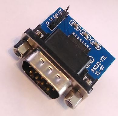

Hi guys,
I'm trying to use Z-UNO in order to pull the data from the UPS, via RS232 serial interface.
I've added RS232 to TTL module to Z-UNO, but no matter what I try, it's not able to communicate. What I tried aleready:
- Module power is connected to Z-UNO pins +5V and GND
- Serial0 (UART0, pins TX0, RX0)
- Serial1 (UART, pins TX1, RX1)
- Connect Z-UNO to UPS via DB9 direct cable
- Connect Z-UNO to PC, via DB9 laplink cable
- Swapped RX/TX wires between Z-UNO and RS232toTTL module
- 2400 baud
- 9600 baud
When Z-UNO sketch is talking to a computer via built-in USB serial, it work fine (using Arduino Serial Monitor or Putty).
When I switch the sketch to use Serial0 or Serial1, nothing comes thru.
Please, do any of you have Z-UNO working with any kind of RS232 module? Maybe that mine is incompatible (got 2 same, none works).
Thanks a lot!
RS232TTL MALE.JPG (30.97 KiB) Viewed 10725 times

What chip is on that converter board? I suspect possible issues if the nominal voltage is 5 V. The Z-Uno outputs max 3.3 V (actually closer to 3.1 V). That might not be high enough to signify "1". Also, it does not accept more than 3.3 V on any pin, higher voltage with no current limit damages the Z-Uno. I a alrost always put 1 k resistors in series with any I/O pin when I am are experimenting.
You could try to power that converter on 3.3 V but without knowing the specs of the chip this is "a shot in the dark".

Hi Peter,
tt's:
MAX3232
ESE+ 1708
So, you mean power this from 3.3V pin and put 1K resistor in series with RX and TX?

Yes. The resistors are there, in case you accidentilly connect the uno to 5 or 12 V. Any partnumber on that chip.

On the chip there's just MAX3232 ESE+ 1708 written, nothing else.
Bought from here: https://www.ebay.com/itm/263286469667

Tht's ok, that is a "typical rs232 converter IC"
According to the datasheet: "Operates With 3-V to 5.5-V VCC Supply"
BTW I have not used RS232 in 10 years :-) my memory is rusty. There is a whole bunch of signals like CTS and DTR that might need to be set, before the UPS wants to transmit. I do not have a clue. Wikipedia, rs232?

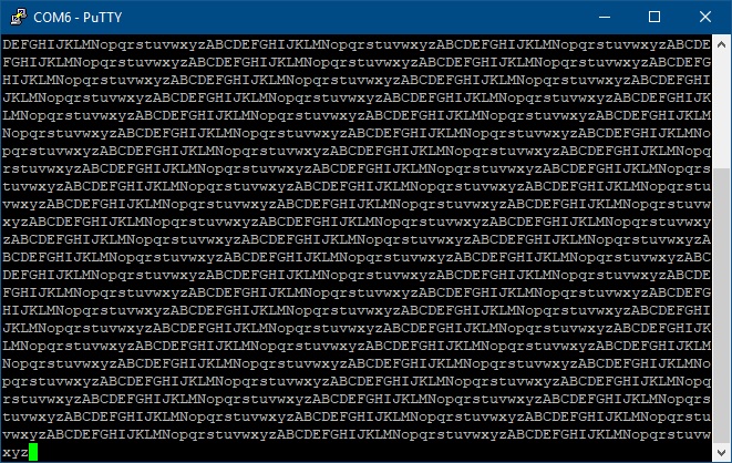

Now it works :)
Z-UNO is sending a text and also able to receive info from RS232. Finally!
I've changed baudrate from 2400 to 9600 on both sides (sketch and Putty) and it started working.
Shame, I need 2400 baud as UPS has fixed baudrate :(
