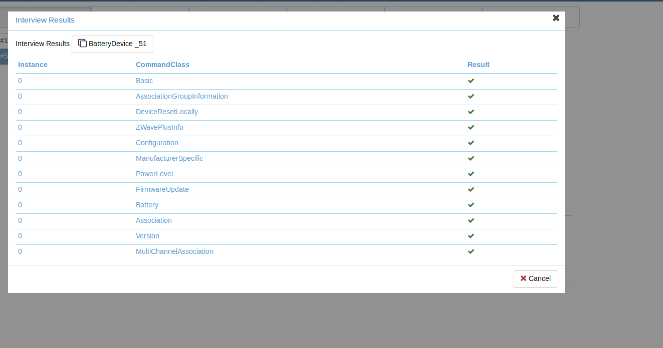

New channel mapping to channel 0
If the channel appears only once, it will not be inside MultiChannel, but rather on the root (channel 0) device only. Additional channels are not created anymore for that case.
Is it possible to get the old behaviour backagain? I would like get the Status of the individual channels / Sensors via the controller.
Thank you foryour answer
p0lyg0n1
Posts: 172
Joined: 04 Aug 2016 07:14
Re: New 2.1.5 release
Post by p0lyg0n1 » 11 Jul 2019 14:04
It's not possible now to change the behavior for the static channels. We add this to the next release/beta functional.
Anyway there is a workaround to do what you want, but you can do it only for dynamic channel approach (see the release notes^^^).
The main idea is to set the channels manually in setup() and process with special mapped variables inside the loop:

Post by samsonbox » 16 Jul 2019 22:55
I have a problem with the
ZUNO_SETUP_SLEEPING_MODE(ZUNO_SLEEPING_MODE_FREQUENTLY_AWAKE);
with the loop I call
  zunoSetBeamCountWU(10);
  zunoSendDeviceToSleep();
but the device does not wake up any more. The Battery and wake_up command class is also missing on the contoller side. But in react on any commands.
