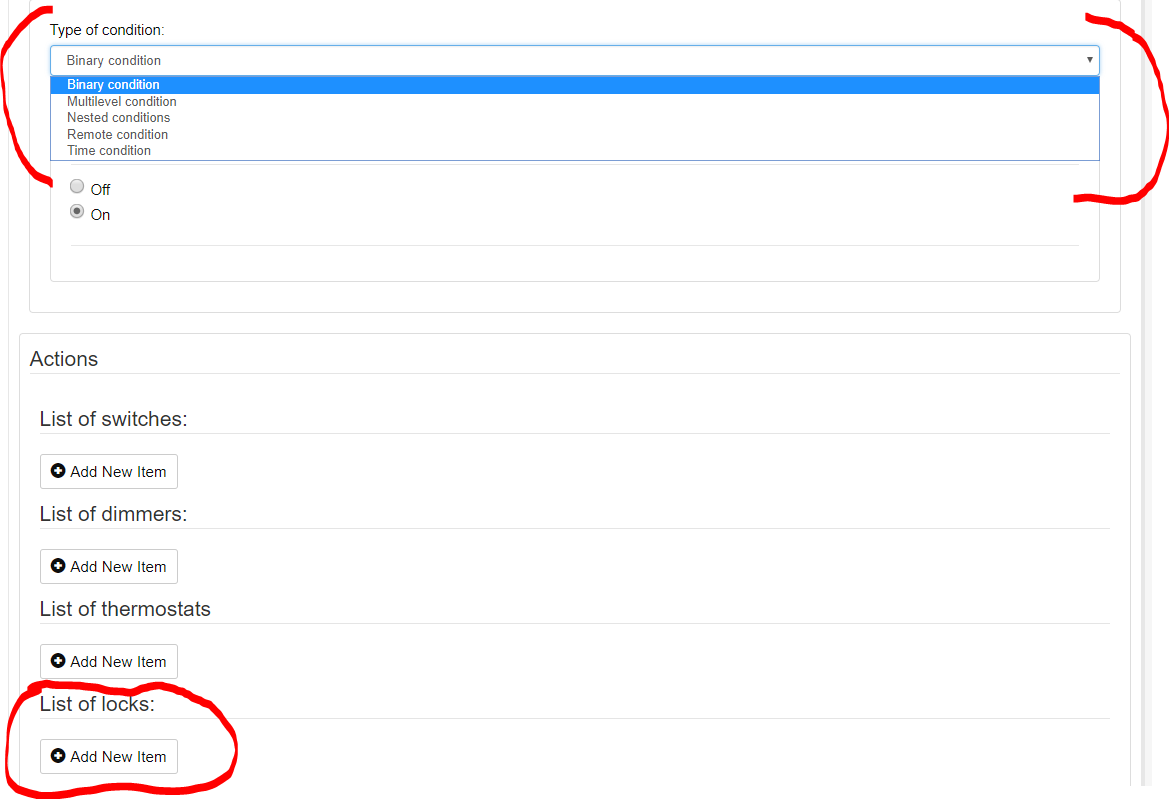

Im on Zway Version 2.3.6 beta for WD and i got no locks under conditions? I got locks under actions, but no locks under binary-, multilevel, nested-, remote-, time condition. And i need a lock based condition, not a lock based action.
