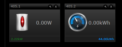

I have defined two channels: One that reports the current power consumption (watts) and one for energy consumption (kWh).
These two channels pop up as two devices in the HC2 and are identified as devices reporting in W and kWh respectively. So far so go good.
However, the HC2 shows 0 W and 0 kWh in the user interface. But if I look at the attributes of the power meter device, it reports the correct number of watts in the "power" attribute, but "0" in the "value" attribute which I think is that the user interface is showing.
This is what it looks like in the user interface:
Electricity meter in HC2.PNG (19.27 KiB) Viewed 40274 times
The values in the footers are correct and are coming from the z-uno. But as you can see, the main values displayed are just zero.
Further to this, the energy panel in HC2 does not include my z-uno reports in the data it presents.
Has anyone successfully integrated the ZUNO_METER_TYPE_ELECTRIC channel into a HC2?

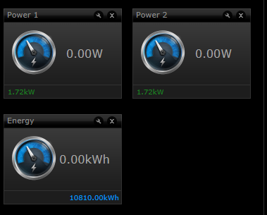

Another issue is that even if I have only defined two channels (one for power and one for energy) the z-uno appears as no less than three devices in the controller: two power meters and one energy meter.
It would not be a big issue if it were not for the fact that the duplication of the power channel/device also duplicates the amount of z-wave messages to the z-uno. I want to keep an almost real time view of the power consumption so the z-uno reports at a high frequency. The trouble now is that every time the z-uno repors a power value, it actually sends two messages instead of one, leading to the z-uno accounting for 54% of all z-wave traffic in my network instead of 27%.

How it looks in my Fibaro Home Center 2 controller:
z-uno electricity meter.PNG (25.67 KiB) Viewed 39872 times
Any idea how I can get rid of the extra power meter?
Re: Electricity meter using ZUNO_METER
You can hide that element in Fibaro UI. I guess it will also supress requests to hidden elements.
perjar
Posts: 57
Joined: 08 Apr 2018 18:02
Post by perjar »
Thanks for the tip, but hiding it in the UI does not disable it, it just hides it from view. The device still generates traffic even when hidden.
The big question in my view is: why does it appear at all? Is this due to an error in the HC2 or in the zuno?
This is because Z-Wave protocol requires that a multichannel device MUST expose it's channel #1 features ouside of channels (we call it channel #0). So all on first channel is duplicated.
perjar
Posts: 57
Post by perjar »
I see. It is a bit confusing though, because I have a number of multi-channel devices in my newtork but none of then display this behaviour. Would that be because they are not complying with standards or perhaps that Fibaro has implemented a "hard wired" fix for these devices in order to hide this double exposure of channel #1?
