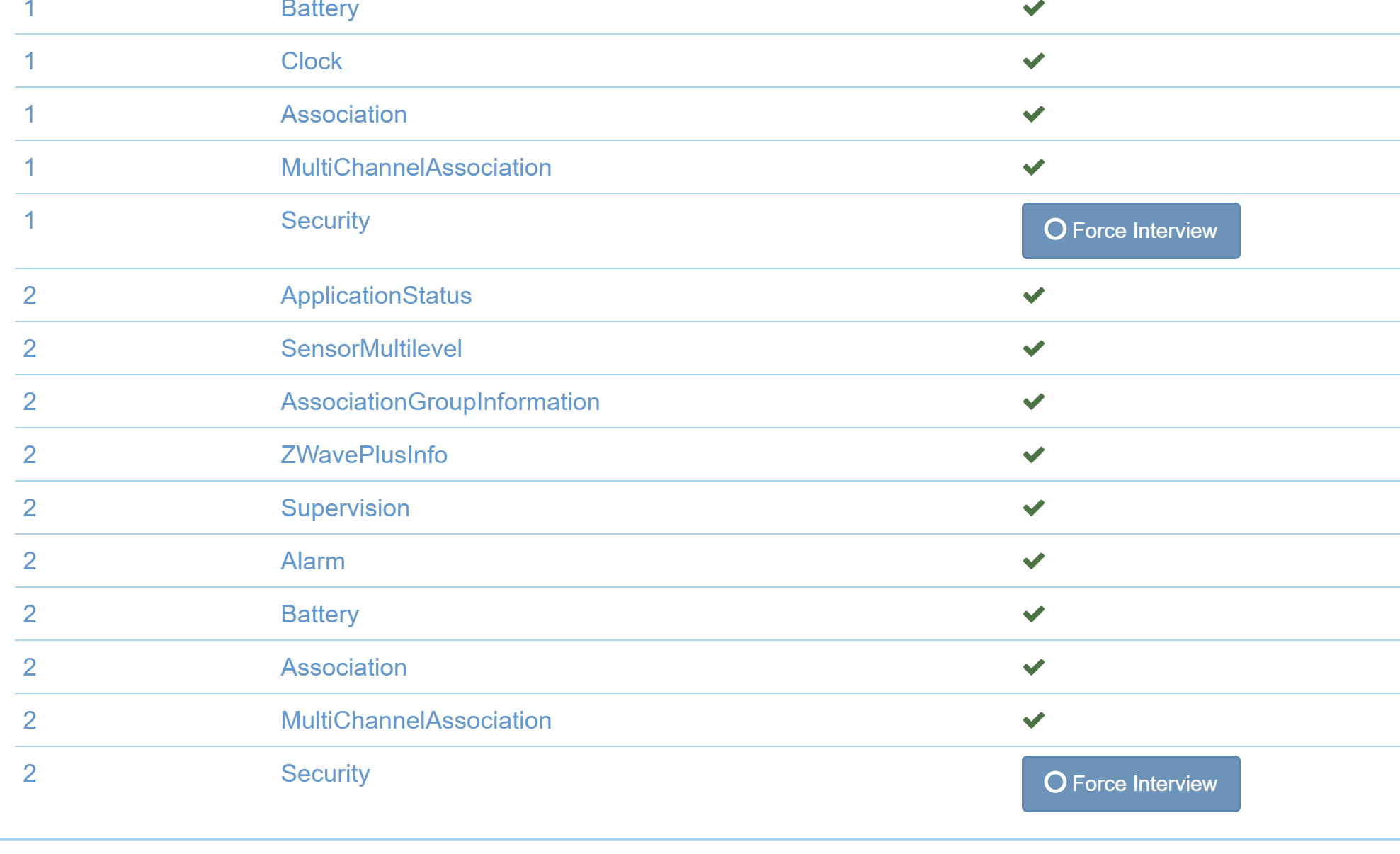

I'm new to this forum. I've been using RaZberry with Z-Wave for a couple of weeks now and it works great. So far this forum has provided all the answers I needed to get my problems solved. Unfortunately, I couldn't find any hints to my current problem.
I managed to include quite a few devices in my Network but now I'm struggling to get my new Fibaro Heat Controller FGT-001 working. The Interview always completes most of the command classes. Nevertheless, the CommandClass "Security" in instance 1 and 2 won't complete. Resetting the device to factory defaults didn't help. Does anyone have a solution to this issue?

The log says:
Node 30:1 CC Security: secure channel not established on root device - can not interview inside channel

Post by IgoriokLT » 14 Feb 2018 03:31
Try to make Insecure Inclusion. Works most of the times with Fibaro devices

Post by phigu » 27 Feb 2018 00:23
I've tried secure and insecure inclusion multiple times. Both didn't finish completely.

Post by pssara » 21 Dec 2018 21:53
I have the same problem. Anyone solved it?
