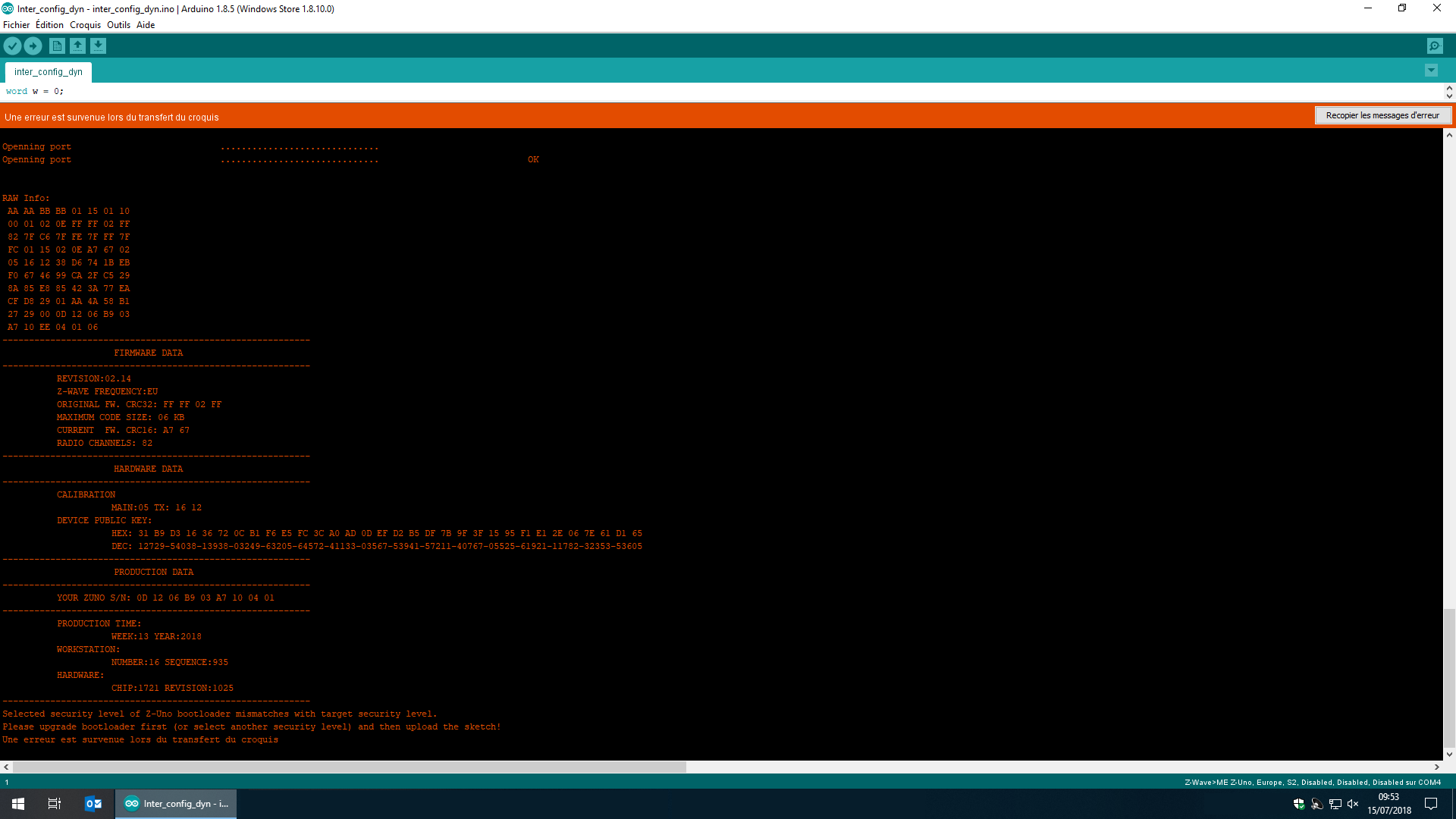

Post by Riri » 22 Jun 2018 10:16
Thank's for this version. I install this but i would like to downgrade at prior version 2.1.3.
I have put the old line "http://z-uno.z-wave.me/files/z-uno/pack ... index.json" in the preference and reinstall completly the version 2.1.3
When i try to download bootloader to the z-uno, i have this message :
Error 0 There is no firmware "C:\Users\ERIC\AppData\Roaming\Arduino15\packages\Z-Uno\hardware\zw8051\2.1.3/bootloaders/\zuno_bootloader_AAAABBBB011501100001020E02*.bin"
I try many combinaison and all fall.
Is it possible that you can't downgrade the bootloader !?
Thanks
Eric.

Post by PoltoS » 22 Jun 2018 10:19
Keep the "test" JSON string and downgrade. The stable branch doesn't know how to downgrade. The test does

Post by Riri » 22 Jun 2018 12:20
Thanks for the quick reply.
I have entry this two lines
https://z-uno.z-wave.me/files/z-uno/tes ... index.json
but, that doesn't work for the 2.1.3
It's necessary to downgrade at version 2.1.1 because it was proposed 2.1.2 and that doesnt' exist.
The number of version is mismack.
I have put the 2.1.1 and the upgarde to 2.1.3 and it's work.
thanks
Eric.
