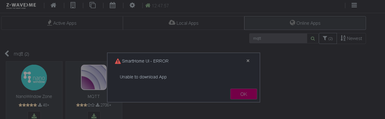

I see this in the log when I try to update an app in the smart home UI
And I get an error that it cannot download the update. I can however delete apps. I was suspecting that I had some folder permission issues.

Actually I am seeing more errors in different areas and have tried on a brand new installation too. I am suspecting that my installation of ubuntu either has some missing folders don't have the right folder permission. Could anyone tell me what folders zway downloads to?

Post by rafale77 » 28 Jul 2018 03:06
PoltoS wrote:
28 Jul 2018 01:21
It should be with libraries. Start the s/w in shell and look in the stderr
aha... found something:
Looking for modules in ./modules
Failed to load module modskininstaller.so: /usr/lib/x86_64-linux-gnu/libcurl.so.4: version `CURL_OPENSSL_3' not found (required by ./modules/modskininstaller.so)
Module modcrypto.so loaded
Module modenocean.so loaded
Module modzbw.so loaded
Failed to load module modnotification2ext.so: /usr/lib/x86_64-linux-gnu/libcurl.so.4: version `CURL_OPENSSL_3' not found (required by ./modules/modnotification2ext.so)
Module moddhs.so loaded
Module modws.so loaded
Failed to load module modiconinstaller.so: /usr/lib/x86_64-linux-gnu/libcurl.so.4: version `CURL_OPENSSL_3' not found (required by ./modules/modiconinstaller.so)
Module modhomekit.so loaded
Failed to load module modhttp.so: /usr/lib/x86_64-linux-gnu/libcurl.so.4: version `CURL_OPENSSL_3' not found (required by ./modules/modhttp.so)
Module modzwave.so loaded
Module modsockets.so loaded
Failed to load module modinstaller.so: /usr/lib/x86_64-linux-gnu/libcurl.so.4: version `CURL_OPENSSL_3' not found (required by ./modules/modinstaller.so)
I checked my libraries and I do have libcurl.so.4. It is because libcurl4 is now compiled with OPENSSL_4 which standard on Ubuntu 18.04 LTS. Can you please update the modules so they can accept both 3 and 4?
