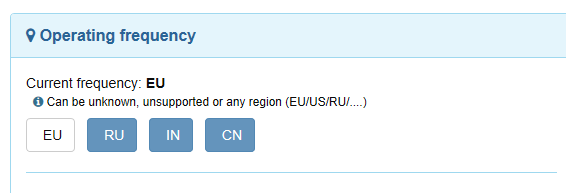

I bought Razberry V2 card from the local seller in Australia and he is insisting that all the boards are for AU frequencies. However, if I go into expert mode I only see EU/IN/RU/CH and no option to set AU/NZ frequency. I have tried the steps in https://forum.z-wave.me/viewtopic.php?f=3422&t=25882

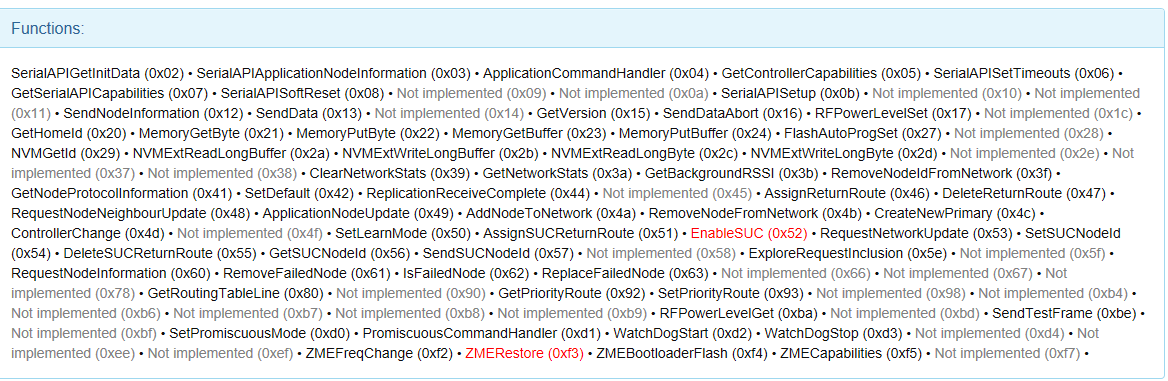

Also why am I having the following ZEMRestore in red in the Controller Info page in expert mode

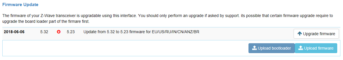

I have updated it to the latest firmware as well.

Do right in the URL /JS/Run/zway.ZMEFreqChange(4)

Thanks, it worked!

Where is the US in the button choices? Firmware says US, but no US selection.
I tried
http://myIP:8083/JS/Run/zway.ZMEFreqChange(9)
and then saw US. I clicked on US and it changed to US.
I now can add devices...

@PoltoS it would be great if the UI can show the ANZ frequency / any other compatible frequencies.
When I first bought the Razberry I spent an entire weekend trying to work the lack of ANZ out; the vendor even posted me a new board in case there was an issue. It took a long time to find thie URL method to setting the freq

I also had this same problem after upgrading firmware. I used /JS/Run/zway.ZMEFreqChange(9) and then I could see US in the list and changed to US frequency. Thanks @DavidL for the info, this got me working again!
