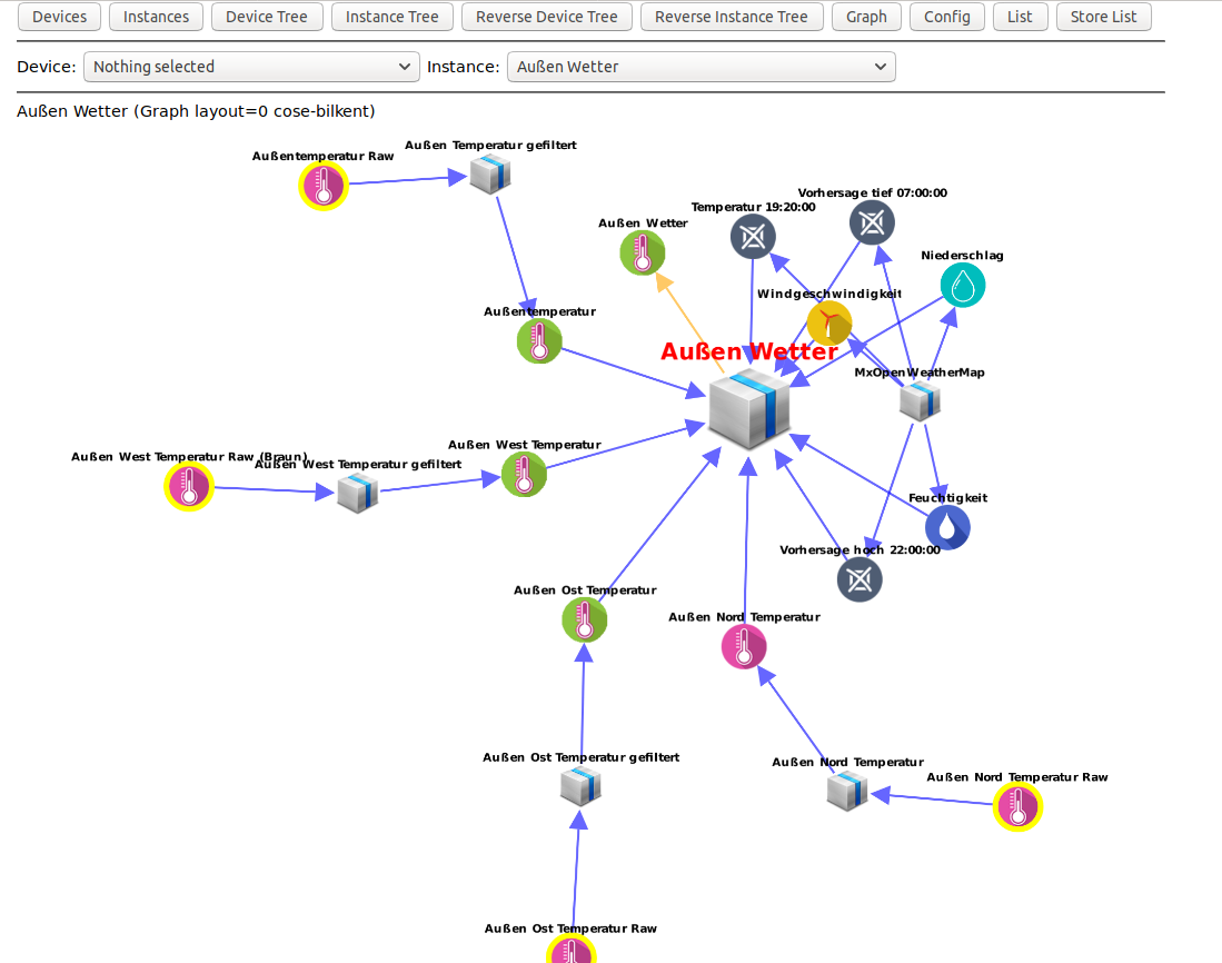

Here a tool which may help a little bit.
You can display the interconnections as graphics, but not the rules
Extract the contents of the zip file to z-way-server/htdocs/smarthome/user/.
Call it, logged in as administrator, with http://<your ip>:8083/smarthome/user/MxInfo and click onto dependencies.html.

Wow! Nice tool for inspection of the API content.

Hi micky,
attached a screenshot of a dependencies graph.
I'm getting none of your errors. Running on Raspi Jessi with Z-Way 2.3.7, browser is Firefox. Must be anything different on your machine.
You can easily delete those functions you don't want to use to save space. I did it for me and for me they were useful.
You can include it in standard package, if it's working. But not all functions are useful for all people. And I don't know how to make it as PR.
Hi micky,
- Bildschirmfoto vom 2019-02-17 20-26-29.png (163.54 KiB) Viewed 9608 times
