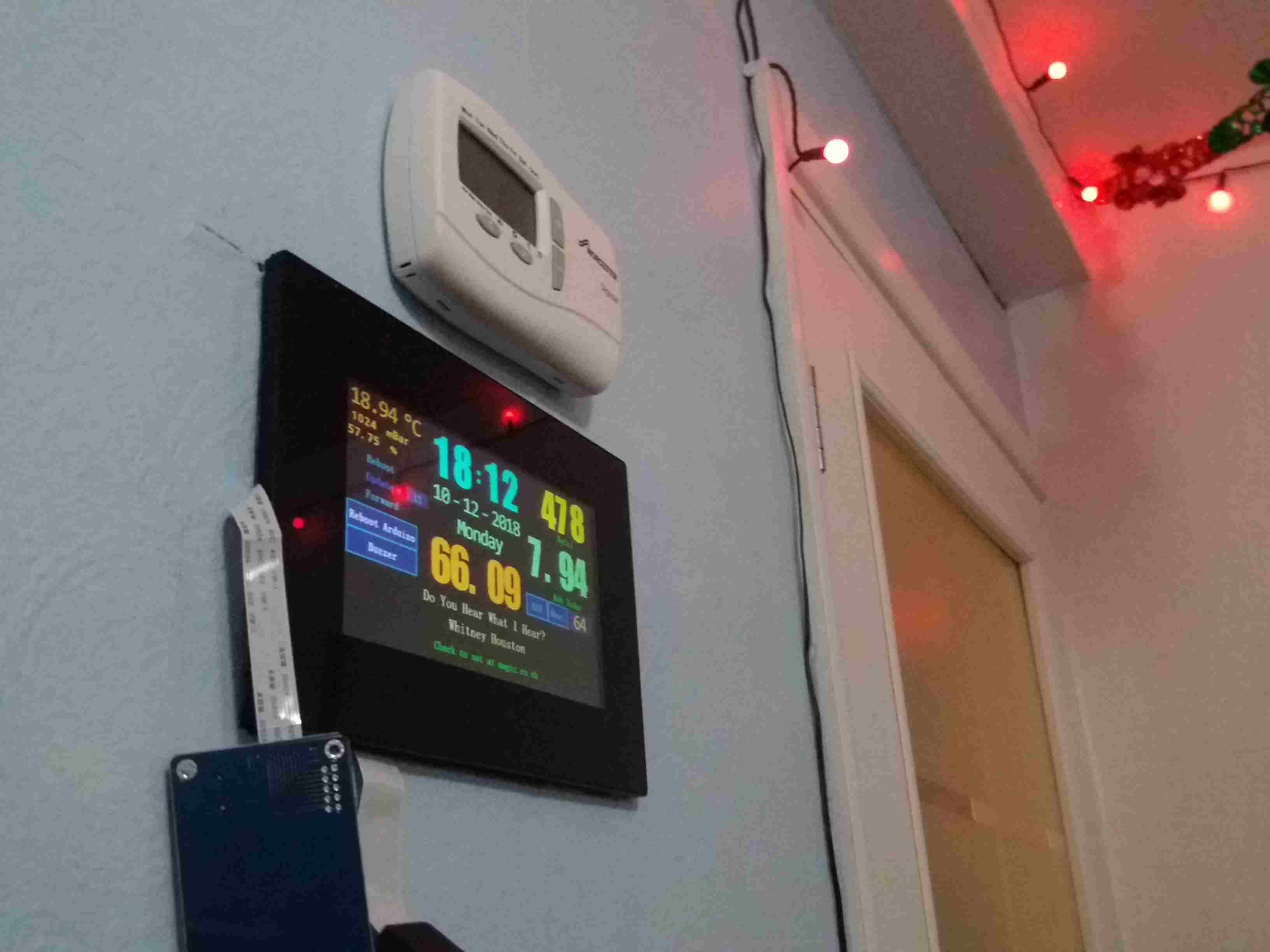

Nice one Vini,
Looks good. Is that on HDMI to the raspberry ?
I'm still working on 7 inch Nextion. Recessed into the wall, All 5 volts though so Arduino controller is up in my loft.
Arduino is networked, so communicates back to z-way over http.
