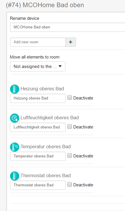

Post by Eagle » 14 Dec 2018 11:54
No, it just shows 4 premade elements:
Heating On/Off switch, this does not show relay status
humidity
temperature
and set thermostat temperature
but, there is a CommandClass called ThermostatOperatingState, where relay status is saved. You could load a custom javascript and save this 1 or 0 to a dummy device.
