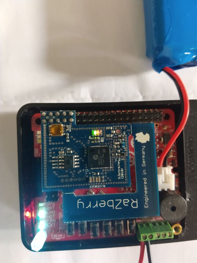

Both LEDs (green and red) on a razberry shield are constantly on right after the power on.
What are the ways to fix it?

Are both LEDs bright or faint? If bright, this is a problem of eeprom. Otherwise the firmware was not upgraded successfully and it is a brick

Both LEDs (green and read) are bright.

Bright means memory problem.

It looks that something went wrong during update like unstable power or something like that. From the log file everything looks ok. So it had to work.
Blue board or green? Can you tell me number on the label?

The board is of blue color.
On the white label (glued to the board):
ZMEERAZ2
Rev 2.1  S/N: 26.18.01
868,42 MHz
Printed on the board itself:
HW Rev. 2.0
11/04/2018
The powersource is an USB power supply recommended by Raspberry.org.
It outputs 2A and 5V.
During update I didn't noticed any power issues, also not before and not after.
Posts: 4613
Re: razberry v2 shield problem (dead?) after firmware update
Post by PoltoS » 05 Feb 2019 02:41
Thank you. We will check it. Meanwhile please exchange yours in the shop where you bought it
