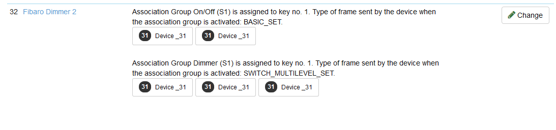

I made an experimental setup with a Fibaro Dimmer 2 and a WallMote Quad to test group associations. After realizing that unless both devices involved in a group association has the same security scheme, the association will not work, I excluded the WallMote from the system in order to do a new inclusion of it, this time with security enabled. During the test, I also erroneously created several associations from the Fibaro dimmer to the WallMote, in reverse to what is correct.
Before including the WallMote, I needed to remove the associations I created during the test. It turns out that this is not doable in the expert UI. I open Device and Active associations and find the associations listed for the Fibaro device. Clicking "Change" only leads me to the Association page for the Fibaro Device and there are no associations listed there other than the Life line associations to the Z-Way.
How do I remove associations in Z-wave.me?
Including screen shots of the UI.

Just to add to the above, it seems a bit strange that associations for devices that have been excluded (=removed from the controller) remains in the UI as is the case with device #31 above.
Trying once more to include the screen dump...

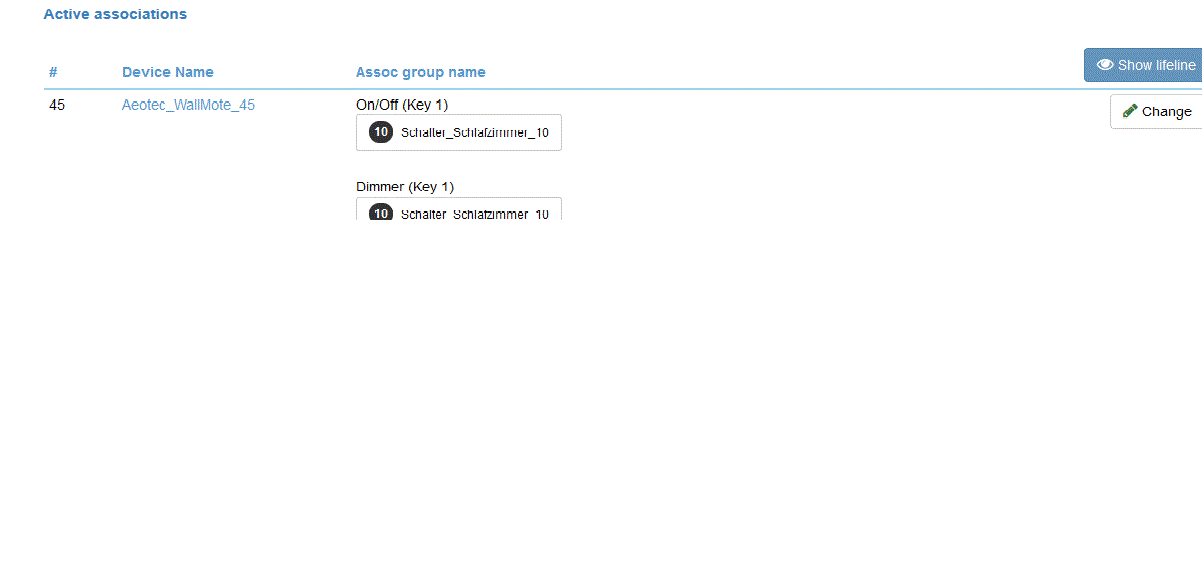

Hi, I have an equal problem, can´t change or delete associations from my Aeotec Wall Quad:
Neue Bitmap.gif (10.2 KiB) Viewed 14107 times
enbemokel
Posts: 499
Joined: 08 Aug 2016 17:36
Re: Can not remove associations in Expert UI
Post by enbemokel »
If I click the button on the right side "Change" and enter the Expert Menu, there is nothing shown. Only the Z-Way lifeline....

Hi Polto, did it, nothing to see or to do. I also can´t set a new association, as the device 10 isn´t shown in the menu.
Any idea?

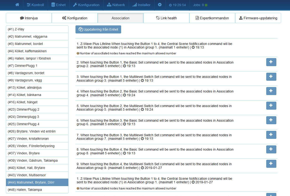

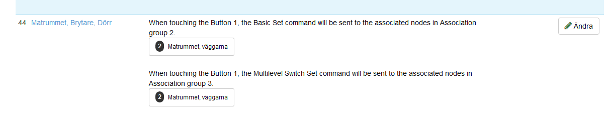

I think there is a bug in the listing of active associations. Include one example of device #44 that according to the list of active associations, have two active associations. When clicking the "Change" icon the association page for the device #44 is shown but there are no associations listed?! This seems like a bug to me.

Could not get image 2 to show up in the thread. Trying to put it here:
