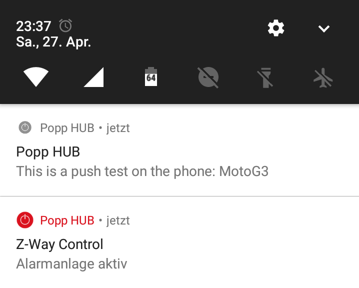

Hi!
I use the Popp HUB App to control Z-Way.
If I get push notifications (from a logical rule) there is no notification sound on my android phone, but the push test message plays my notification sound.
I noticed that these seem to be two types of notifications.
The one that works with sound is grey and says "Popp HUB" as subject. The one without sound says "Z-Way Control" as subject and has a red icon...
See attached screenshot
Any ideas?!

OK... got it.
in MobileAppSupports index.js for command "alarm" the message creation for android phones is wrong. I changed it from
message = {
                                                     to: deviceToken,
                                                     notification: {
                                                             title: "Z-Way Control",
                                                             body: alarmMessage
to
                                        if (os === self.ANDROID) {
                                                message = {
                                                        to: deviceToken,
                                                        data: {
                                                                type: "alarm:message",
                                                                data: alarmMessage,
                                                                hubId: hubId
                                        } else if (os === self.IOS) {
                                                message = {
                                                        to: deviceToken,
                                                        notification: {
                                                                body: alarmMessage
and now it works 8-)
