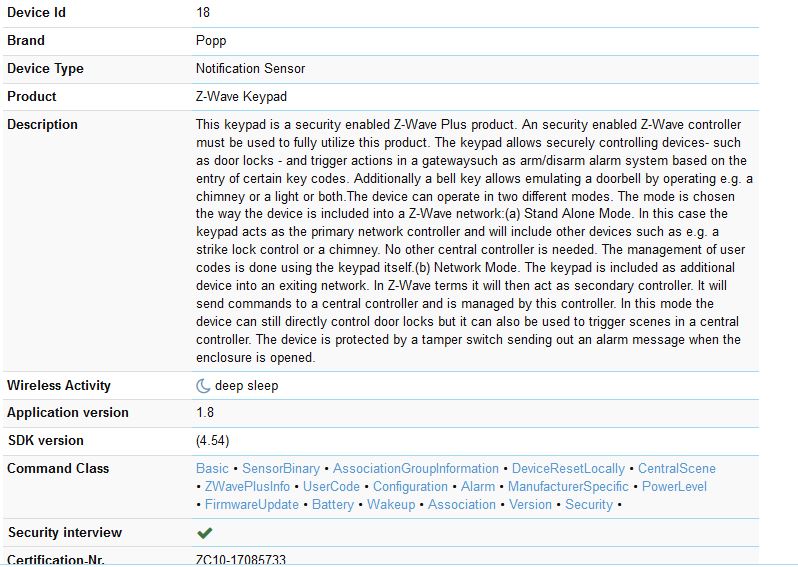

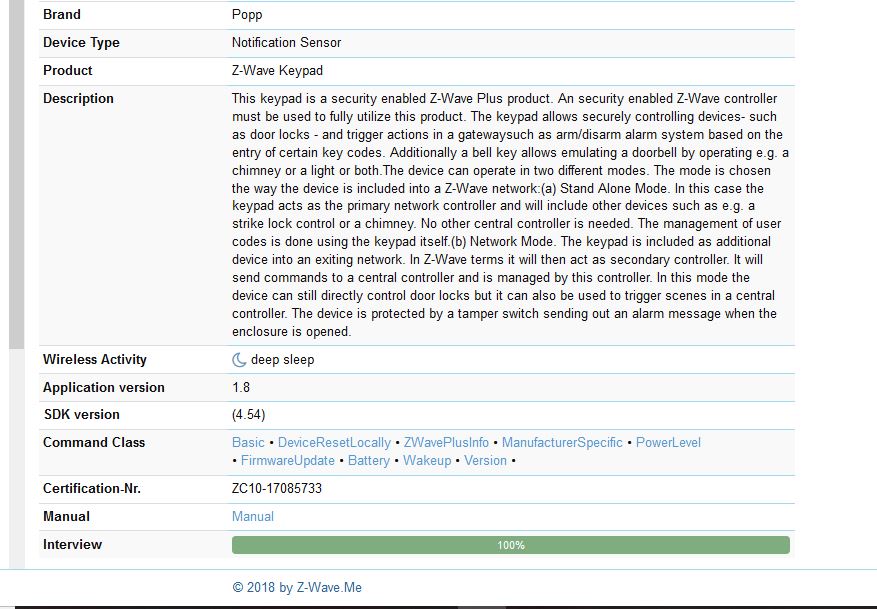

Post by piet66 » 29 Aug 2019 16:45
I tested with secure and with unsecure inclusion. Both with same problem.
Indeed it may have anything to do with Security command class.
The NIF now includes 9 command classes. They are identically with the 9 classes from my previous trials, minus Basic plus Security. Security was missing in the wrong interview results.
I'm wondering why ZWay told, that interview was completed for 100%. And I'm wondering why NIF only contains 9 classes whereas the interview results now contain 17.
current classes
Bildschirmfoto vom 2019-08-28 19-26-52.png (40.82 KiB) Viewed 1490 times
previous trial
Bildschirmfoto vom 2019-08-27 15-45-26.png (27.83 KiB) Viewed 1490 times
