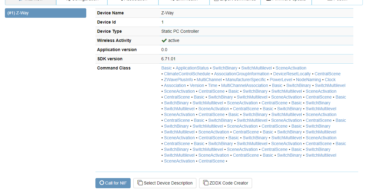

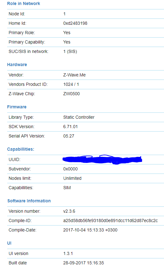

After some testing, 2.3.6 was very fast and nice, but my Fibaro Motion Sensors were gone. Only the PIR was missing, temperature and light intensity still worked.
So i decided to try some things out and amongst other things i updated my bootloader and UZB firmware to 5.27.
Now i only got 1 device in my list and thats the controller itself. i tried to reinstall, reset, restore zab and zbk files, and so on.. but nothing worked.
If i press the inclusion button in expert, an error message with Unable to update data. controller.AddNodeToNetwork(1) shows up.
Postfix of the controller shows only This device has missing product ID.
I need some help! i got more than 40 devices in my network...
edit: i think the bootloader update did not work. but ive tried to go down from 5.27 to 5.07 again and all the way up to 5.27, but that also did not work. is there some sigma windows program to manually flash the bootloader? Or maybe its a binding error? its set to /dev/ttyACM0
I uploaded a screenshot of my controller info and controller interview, application version is 0.0?
