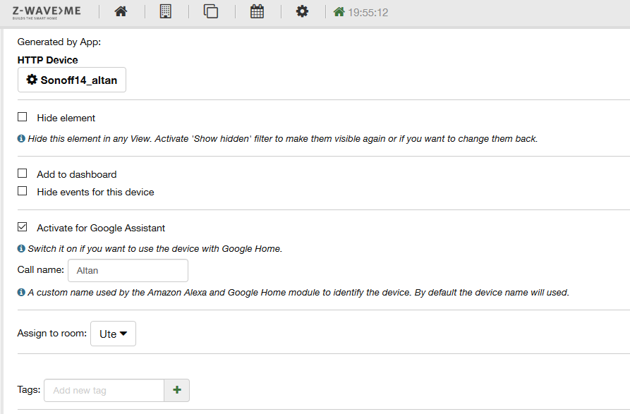

I still have problem with adding zwave.me to google home.
I found that i could activate Google home Assistans on devices in Z-way user interface.
But still when I try to Link my account in Google home i get " Smart Home UI- ERROR Unable to update data"
even if I select 1 room or all rooms.
Is there a known bug/problem?

Please go to the Google Assistant app and link with Z-Wave.Me.
