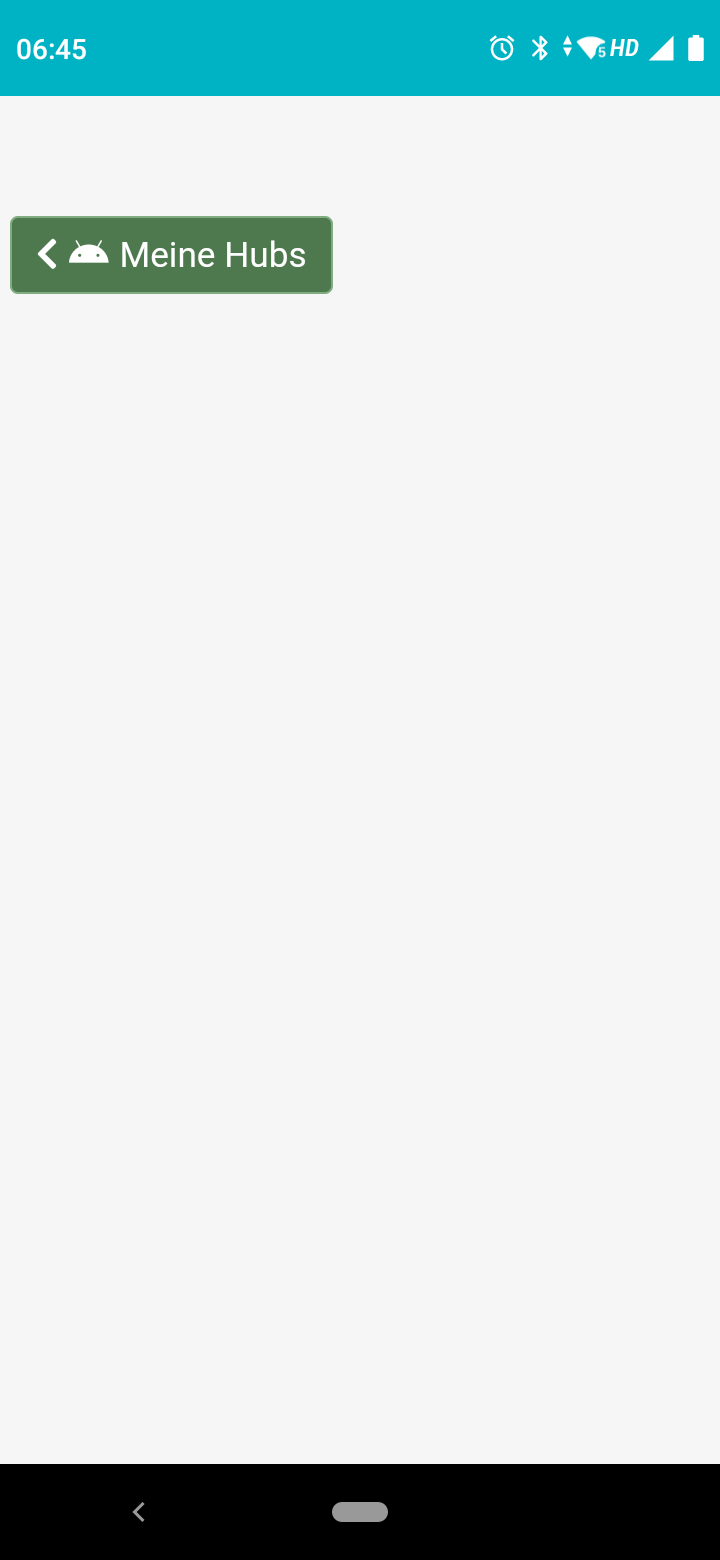

The App works without any problems when I use mobile data (-> remote connection via find.z-wave.me).
If I am within my network / WiFi-Connection I only see the attached screen. If I tap the "my hubs"-button, I get back to the hubs overview. If I select my hub there I see the attached screen again.
I cleared the cache of the app, deleted and re-installed, but the issue remains. The local IP is correct.
I'm using a RasPi 3 with raZberry 2 addon board and z-way version 3.1.2
Tested with two different phones: Xiaomi Mi A3 (Android 11) and Motorola Moto G5 (Android 8)

hm... we have seen this happening for some users. Hope we have fixed it. If we provide you an RC, can you check it?
Re: New iOS and Android apps for Z-Way
@PoltoS: sure
Please try this https://github.com/Z-Wave-Me/zwave-smar ... ve/dev.zip
cd /tmp && wget https://github.com/Z-Wave-Me/zwave-smar ... ve/dev.zip && unzip &&
cd /opt/z-way-server/htdocs && sudo mv smarthome smarthome.orig && sudo mv /tmp/zwave-smarthome-dev/dist smarthome
To switch back:
sudo mv smarthome smarthome.dev && sudo mv smarthome.orig smarthome
To switch back:
Don't forget to clear cache in the mobile app for your profile
