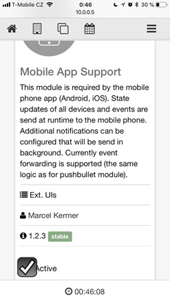

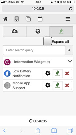

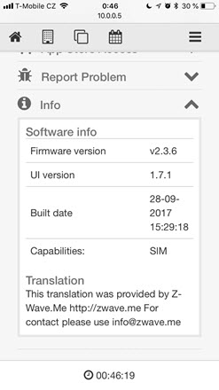

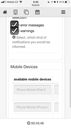

I have successfuly installed last available Z-wave server version 2.3.6 for my WD My Cloud EX2 Ultra (not signed by WD yet, but I dont believe WD will sign any new versions since it is over half a year It was submitted to WD). I did clean install with reinclusion of all my devices. Licence was recognized already from version 2.3.0 (I suppose it is saved on USB stick). Everything works great except two things:
1) I dont know if I understand mobile push notifications right, but I was thinking if eg. door is opened, I will receive push notification on my iPhone automatically. But I was not able to make it working. I see both my iPhone and iPad in Mobile App Support module, I dont know if something else needs to bude configured or some additional modules installed. I include screenshot of Mobile Apps Support module configuration.
Update: User Eagle confirmed to me, that push-notifications are not working on WD devices reliably, so I think I will relly on Pushbullet, which is sending notifications without any problems to my iOS device.
2) I was thinking, that netatmo module crashing whole z-wave server wont be present on 2.3.6, but it still is. I install netatmo module, connect it to my netatmo account, all elements are created (except the additional indoor modules, which is known issue/bug) and then after few seconds Z-wave server stops working. I need to disable access on dev.netatmo.com to stop data pulling into netatmo module and then I need to reboot Z-wave server, only after those actions I am able to remove netatmo module. Its sad, because I would love to have netatmo module working and it seems it is more netatmo module issue than Z-wave server version related issue.
