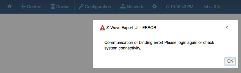

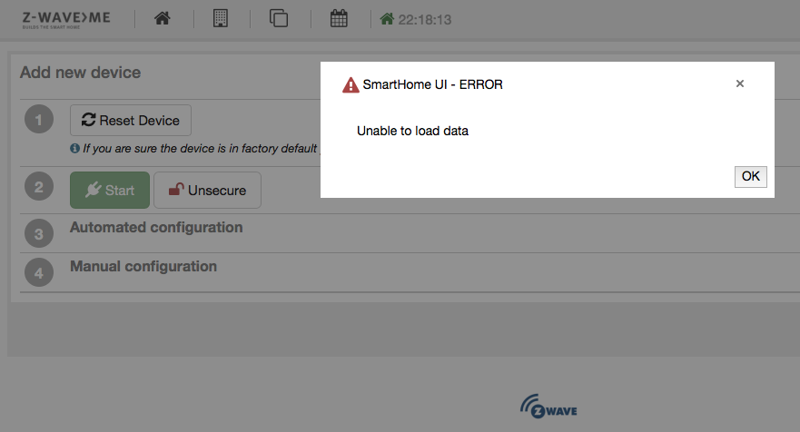

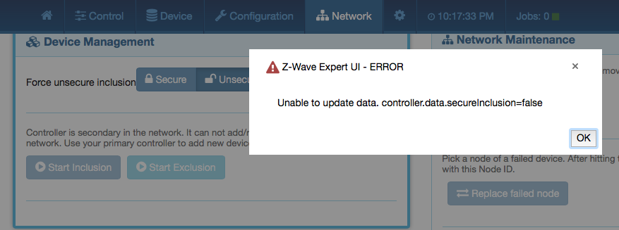

I can reach the login of Z-Wave but when I try to add a device I always get an error popup.
SmartHome UI - ERROR
Unable to load data
Also switching to ExpertUI shows up an Error message.
Z-Wave Expert UI - ERROR
Communication or binding error! Please login again or check system connectivity.
Adding or excluding a device doesn't work and besides the the error messages it's doing nothing. :(

DJay
Posts: 8
Joined: 11 Dec 2015 12:18
Re: Z-Way under Raspbian Stretch
Post by DJay »
lordchilli wrote:
30 Jun 2018 01:19
I had exactly the same problem. Please try this:
https://forum.z-wave.me/viewtopic.php?f=3422&t=28954
I can't thank you enough. Bluetooth and baudrate was the missing part.
Thanks to your great step by step instruction, everything is working now as it should with z-wave.me razberry on my Pi 3 B+ stretch.
Many thanks.
