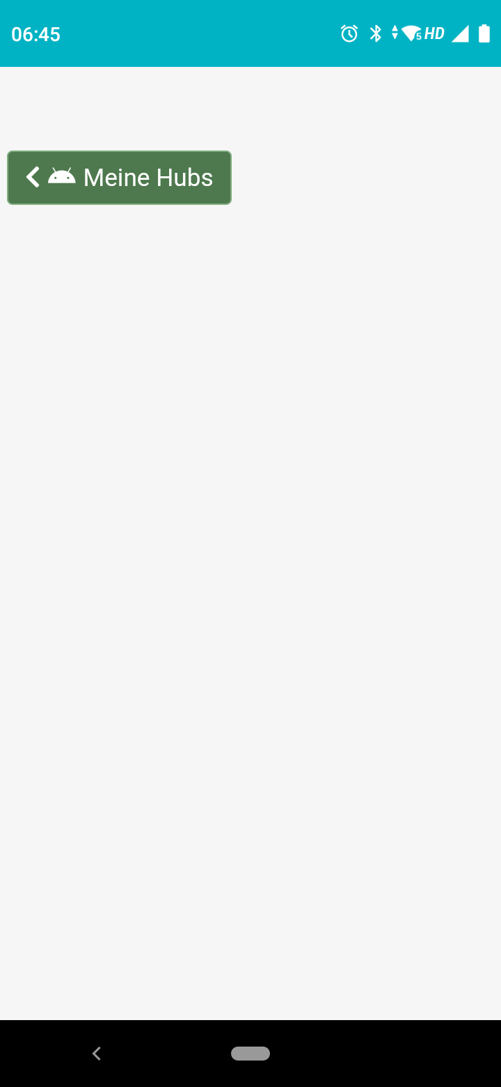

Is my understanding correct that the “Hubname” is free to choose?
I tried to connect a Nokia 7 Plus with z-wave.me app version 1.1 to z-way server version 3.0.5. The apps description tells it will work with 3.0.5. It only focused the QR-Code but did not scan. When manually entering the local IP it did not connect and did not show any error message. Entering IP and port is not possible. Is it necessary to enter the port?
And as I boycott google, is there a place to download the most recent apk file to get it on my phone without playstore?

Yes, this is to differenciate one house from another

No need to enter the port - it is filled automatically with 8083.
Please note that the QR-code should be located under Settings->Devices->Mobile phone->Add.

Sure, any APK storage like https://apkpure.com/z-wave-me/me.zwave.zway
