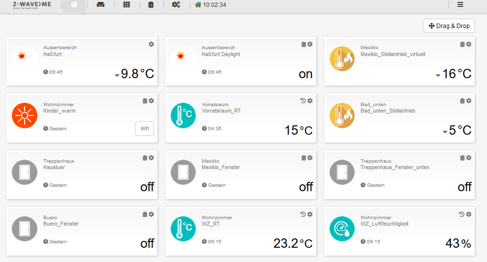

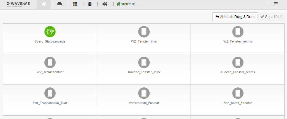

Hello all,
please check and possibly withdraw the update, because at each new login via browser the items are scrambled on the dashboard and in rooms. When you hit the move button the items are sorted again, but you cannot save until you move at least one and when you save it it works only until you start the browser again. Unfortunately I did the update without waiting for some more experiences.
Does not depend on the browser. Checked it on my Laptop and Samrtphone with Firefox, Chrome and Edge.
Please help, how can I downgrade? So its completely useless for me.
Btw: the android app still does not work with 3.1.3. It stucks in a loop after you enter the login data.
Scrambled
Scrambled
