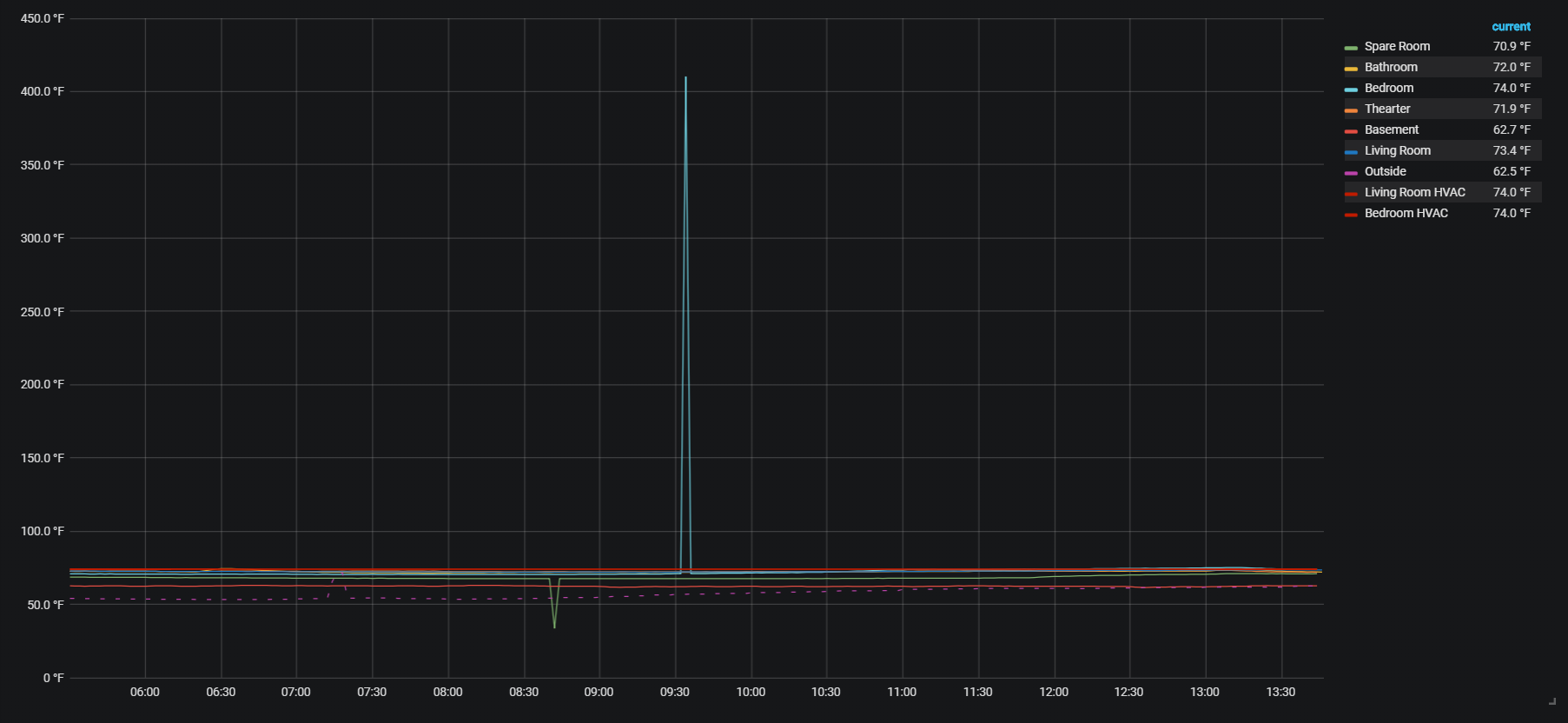

So I occasionally get absolutely crazy outputs from the sensors in my Z-wave network. For example, My bedroom has never reached 410 degrees :lol:
This does not just happen with my Aeotec Multisensors, this also happens with the voltage readings from my Zooz power switches, and a couple of plug in power switches from monoprice. So this does not appear to be a device specific problem. These sorts of readings wind up triggering rules based on these sensors, which is less than ideal. It also completely screws up the auto scaling of my monitoring graphs.

Removed periodic sensor polling entirely, and setup everything to send reports automatically.
Got a report that it was 4.8 million degrees in my bathroom. :shock: I've also gotten a read of 0 volts out of one of my Zooz wall plugs as well.
It seems that z-way needs some sort of sanity check for this. The devices themselves just seem to send bad data sometimes. :(
