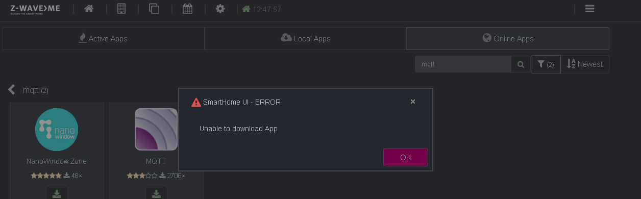

Hi, found via google. I have z-way installed on ubuntu. I can't install any app.
Welcome to Ubuntu 18.04.4 LTS (GNU/Linux 4.15.0-99-generic x86_64)
Tried to install mqtt app but get error.
I have tried to apply above code. but how to proceed?
