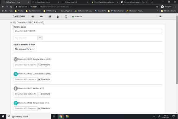

So overnight with Philip Hue off, the other apps on and a full reboot, 6hrs 19min run time has 1.5Gb disk write - a huge improvement. 1hr 22mins later once movement in the house has started and it's up to 2.7Gb.
Other than Philips Hue I'm wondering if this is an issue to do with too many devices, all reporting several value's (PIR, temp, humidity, lux etc)? Since disabling Philips Hue I've noticed a vast improvment in reaction speed of lights turning on so I''m going to phase it out for z-wave.
To try and reduce things, is it enough to go into Z-Way devices and disable events that are not required, or would I need to do this on the sensor configuration?
NEO disable.png (67.75 KiB) Viewed 11356 times
