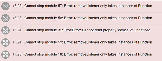

I've more or less redone the zway apps, quite a few were saying duplication errors when saving any changes so I've redone them all. I still have the old ones paused, so what I'm not sure about is whether I can safely delete the old ones as a few I tried have flagged errors as the pic below. I've seen a previous post on correcting the duplicates using jsbeautifier, but learning that is for another day I was just needing to get things working again.

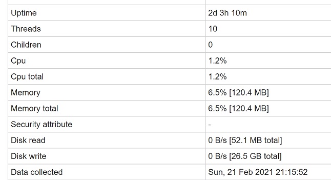

Below is a better write rate, 26.5Gb in 2 days is much better than in a few hours as I initially was getting. I've been going through some sensors to try and stop what I don't need or reduce the transmition frequency of what I do, I've still got some improvements to go.
The main thing is I now have a useable system again with very fast acting lights etc.
