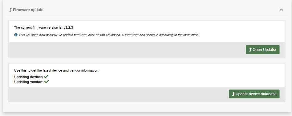

Z-Way software 3.2.3 Razberry 7 (firmware version is: 7.26 [Bootloader: 1766938484]) firmware update does not work
When updating from the Z-Way settings section, a page exits.
The IP-RaZberry site does not allow you to establish a connection.
What can be done?
I can't open tab
Until the problem is solved, how can you reboot and shut down the Raspberry Pi without using the terminal.

Z-Way.
Clicking the Open Updater button opens a blank page.
Moreover, this situation also occurs on another Raspberry with Razberry 2
Raspberry Pi 4, Raspberry Pi OS Lite (Debian version: 11 (bullseye),
Z-Way for Raspberry Pi, RaZberry 7 Pro, RaZberry 2

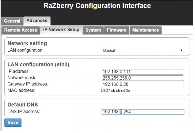

It works for me. So maybe there is something on your network or ISP that is blocking it. Your gateway also seems odd. While the gateway can be any IP from 1 to 254, usually it is .1 or .254; first or last IP. You have 192.168.0.28 configured. Are you sure that is your gateway? It could also be a DNS issue as your DNS server is set to 192.168.0.254. So it looks like you either have a gateway issue or a DNS issue.
3.2.3 is the latest Z-Way version. That is also what you show as running.
Screen Shot 2022-08-19 at 8.08.40 PM.png (487.24 KiB) Viewed 6933 times

It's just a picture from the internet. I can't open this page.

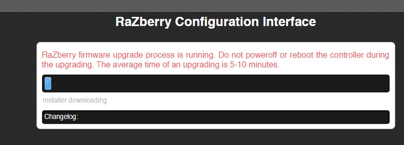

In the interface
The update can last indefinitely, and will not end.

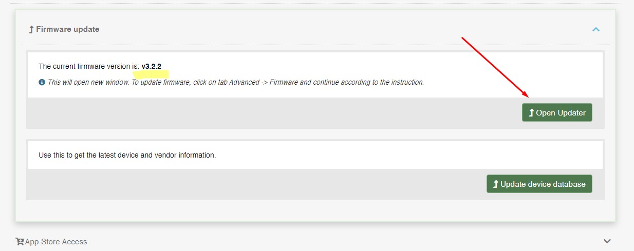

I tried to install Z-Way on Raspberry Pi OS Full, the problem remained.
Version 3.2.2 does not have this problem.
Everything opens as it should.
