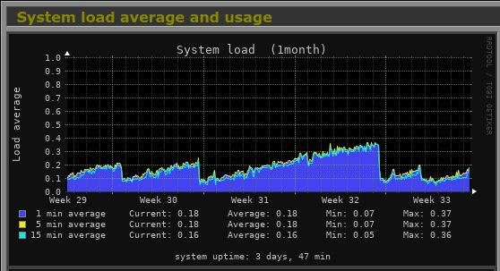

In my system the cpu load of z-way-server increases continuously from ~5% after start to >30% after 2 weeks. Then at latest I should do a restart.
Bildschirmfoto vom 2022-08-20 10-18-23.png (35.08 KiB) Viewed 11373 times

I closed all logins and stopped all not essential apps, but that had no effect on the system load.

After 2 days running, I can state that the problem is solved.
Thanks
