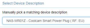

Ok, thanks, I'll go with the un-secure way then, as I don't know the pin.
Do I have to select the Device description, manually, or it there a way to get z-way to learn this device ?
