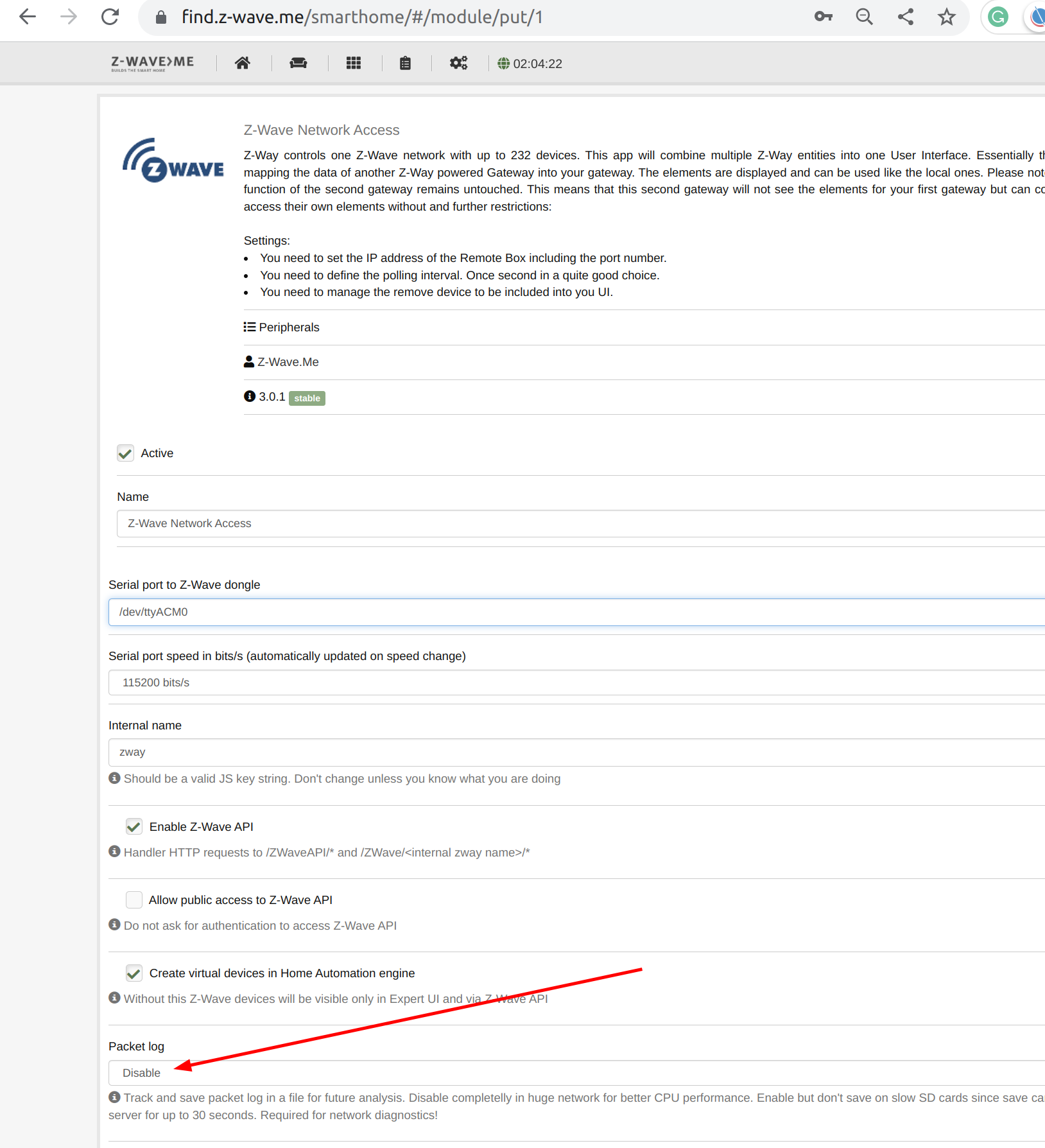

Posts: 7649
Re: Route map empty
Looks something went wrong in the UI. Please try to clean the cache. If this does not help, please provide remote access
Posts: 7649
Re: Route map empty
Looks you disabled packet logging (this improves the speed, but disabled analytics)
Z-Way Z-Wave Binding settings

Poltos, Thanks! I do remember a disabled Packet Log. Sorry I didn't know Packet Log was needed for the Route Map.
When enabled it works perfectly.
