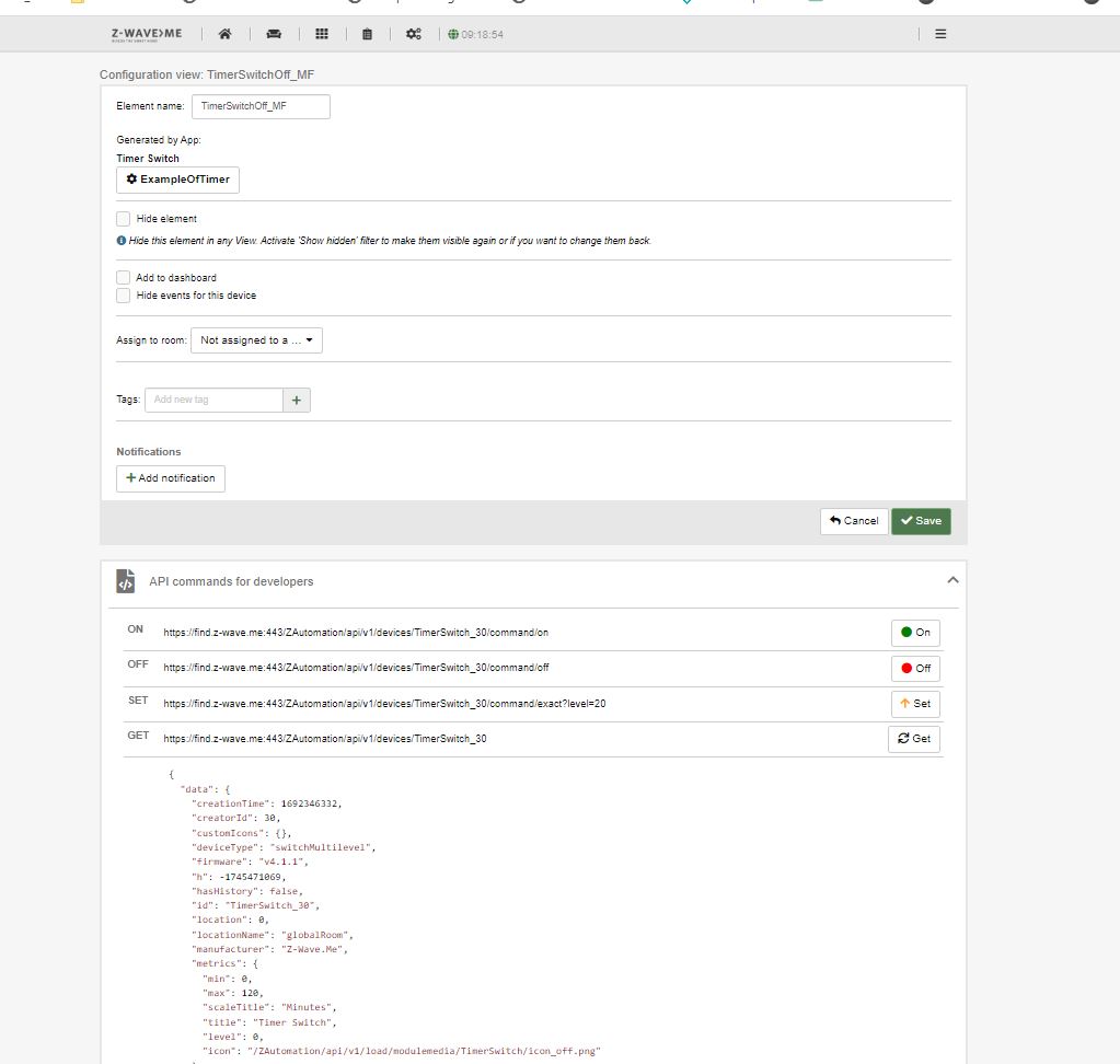

My problem is diffrent , I am using the App Timer Switch to Switch ON a Motor of Fan ( physical device) , for let’s say 15 minutes and Switch off the the Motor Fan for 60 minutes, this being trigger by rules.
What I need is having a User Role to be able to change the time that the Motor Fan is ON and OFF.
The way I am doing ;
1- Install APP Timer Switch

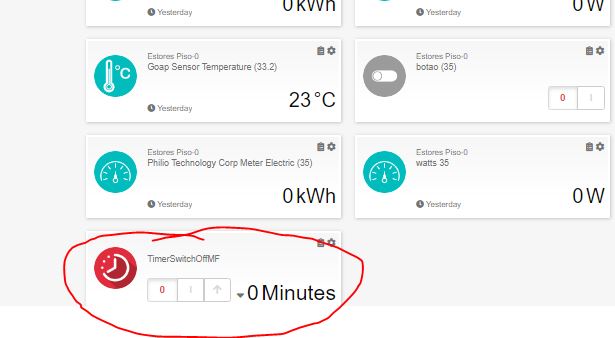

2- Create Timer for Switch Off Motor Fan
3- Create timer for Switch On Motor Fan

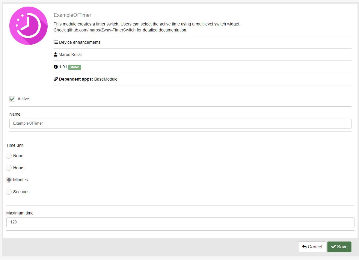

4- Set time parameters for both Timers : Maximum time and change to minutes.
5- The two timers become available in Zway UI.
6- Create rules using Both Timers
7- All works very well.
8- Problem – How to adjust Timers Maximum Time without being having administrator rights ? In PIC-2 there is the API and the value i want to change is "max":120. Changing the level value works , but not the "max value.

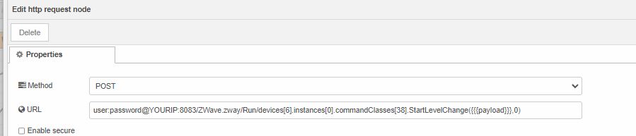

As curiosity , In attachment a Pic with POST method i use to change value on Node-RED.

Oops. I did not understand you wanted to change a parameter that's part of an app. What you want to do can be done, but it's a bit more complicated since the expert UI does not provide API information for virtual devices and the smarthome UI does not provide low-level API information for apps. To make it easier to understand, I'll give you the answer first and then I'll explain how you can change a parameter for any app.
Here's an example curl command to change the maxTime parameter to 30 in the TimerSwitch app that you can run on your Pi to do what you want:
For Node-RED, use the URL shown above in the http request node, choose the PUT method and pass in the following msg:
msg.payload = '{"moduleId":"TimerSwitch","active":"true","title":"Timer Switch","params":{"unit":"minutes","maxTime":30}}';
You will also need to add a Header for Content-Type with value application/json. You can either do this in the http request node UI or I think you can also add the header by passing in the following msg:
msg.headers = {};
msg.headers['Content-Type:'] = 'application/json';
The general approach for figuring out the correct HTTP request to change an app parameter takes 2 steps. First, you first need to determine the instance ID of the app you want to change. To fetch all instances of the TimerSwitch module, run the following curl command on your Pi:
Next, fetch the instance information using the instance ID by running the following curl command on your Pi:
I'm pretty sure these curl commands will work on your Pi because your PIC-2 API displayed the module ID as "TimerSwitch" and the instance ID as "30" (separated by "_" character).
Make sense?

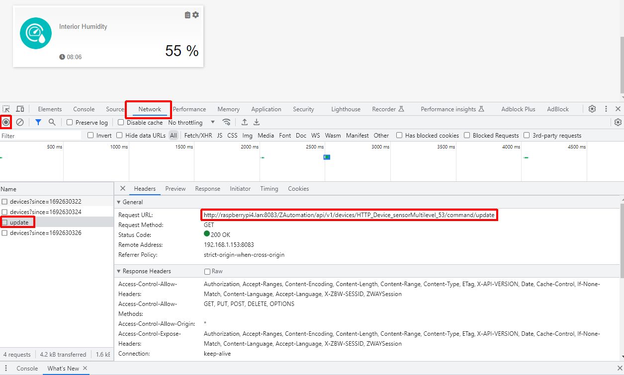

Here's what I do to "see" and understand the automation API commands...
1. I use the Chrome browser and enable Developer Tools where the Network tab shows me the requests and responses sent between the browser and z-way-server process (specifically, the zway/webserver thread). This is useful whenever the web UI does something that I want to do manually/programmatically - Developer Tools shows me the API request and response. Here's a screenshot of what appears when I press the button for a multilevel sensor (which causes the sensor's value to get updated): Developer Tools shows the browser sends an update request to Z-Way. One of the things you'll quickly observe in Developer Tools is that the browser makes a request to Z-Way every 2 seconds asking if any device changes occurred in the previous 2 seconds. I suggest pressing the Stop icon in the Developer Tools after you've taken an action on the web UI since the every 2-second device change messages can obscure the API exchange you're trying to see. Please understand that climbing the Developer Tools learning curve is not a topic for this forum.
2. The Z-Way developers maintain the automation API documentation here:
Taking the Developer Tools network trace example for the update request shown above, you can see the API information for sending a command (e.g., the update command for a sensorMultilevel virtual device) here:
The list of commands that are possible for a virtual device are here (note that different device types will have different commands):
Hopefully you see the only valid command for a sensorMultilevel virtual device is update.
Taking the Developer Tools network trace example for the 2-second device change poll message, you can see the API information here:
Putting the pieces together... when the button for a multilevel sensor is pressed on the web UI, the browser emits an update command request for the sensor. Then the browser sits there and does nothing until the next 2-second device change request. Z-Way will respond to the device change request (presumably by sending an updated value for the sensor). In the web UI design, the action to update a multilevel sensor is asynchronous with the sensor level change being reported. In other words, the updated display for the sensor level is in response to the device change request and is not tied to the update request (although, the update request triggered the sensor's value to be updated).
