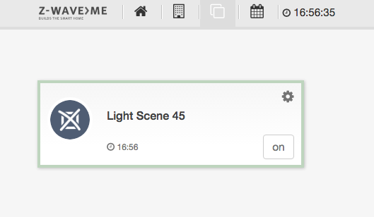

Very interesting - I created a scene that activates PushME. When I click "On" on the dashboard for this new scene it just sends one notification (see attached screen shot), but for some crazy reason when activated the same scene with "If -> then" (same scene that I pushed "On") it sends two. So crazy weird. Any ideas?

Have the same issue with Push-ME sending notifications twice :-(
Sens a single notification when the scene is triggered directly and two if its triggered by the if->then app. Using logical rule instead of if-then also makes no difference.
