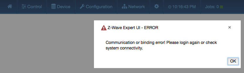

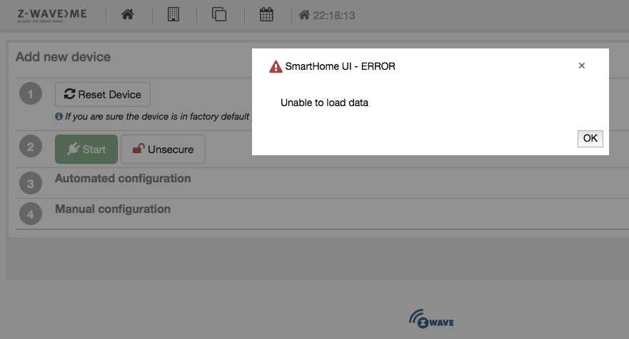

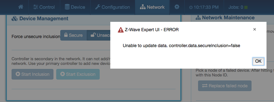

I can reach the login of Z-Wave but when I try to add a device I always get an error popup.
SmartHome UI - ERROR
Unable to load data
Also switching to ExpertUI shows up an Error message.
Z-Wave Expert UI - ERROR
Communication or binding error! Please login again or check system connectivity.
Adding or excluding a device doesn't work and besides the the error messages it's doing nothing.

wget -q -O - razberry.z-wave.me/install | sudo bashSmartHome UI - ERROR
Unable to load data
