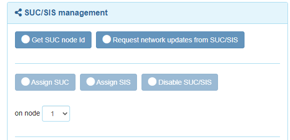

Hmmm. You have me stumped. Here's what I see (not greyed out):
Perhaps clicking on the "Get SUC node ID" button or the "Request network updates from SUC/SIS" button might re-enable the options.
Have you modified the Defaults.xml config file (nominally, /opt/z-way-server/config/Defaults.xml)? The following line should be present:
<TryToBecomeSIS>1</TryToBecomeSIS><!-- Shall Z-Way try to become SIS -->
There is a Z-Way API call (SetSUCNodeId) that you could try, but I suspect it may not be successful since that's what the GUI uses. If you want to give it a try, run the following command:
curl -u admin:[YOUR ADMIN PASSWORD] --globoff 'http: //127.0.0.1:8083/JS/Run/zway.SetSUCNodeId(1,1,1)'
