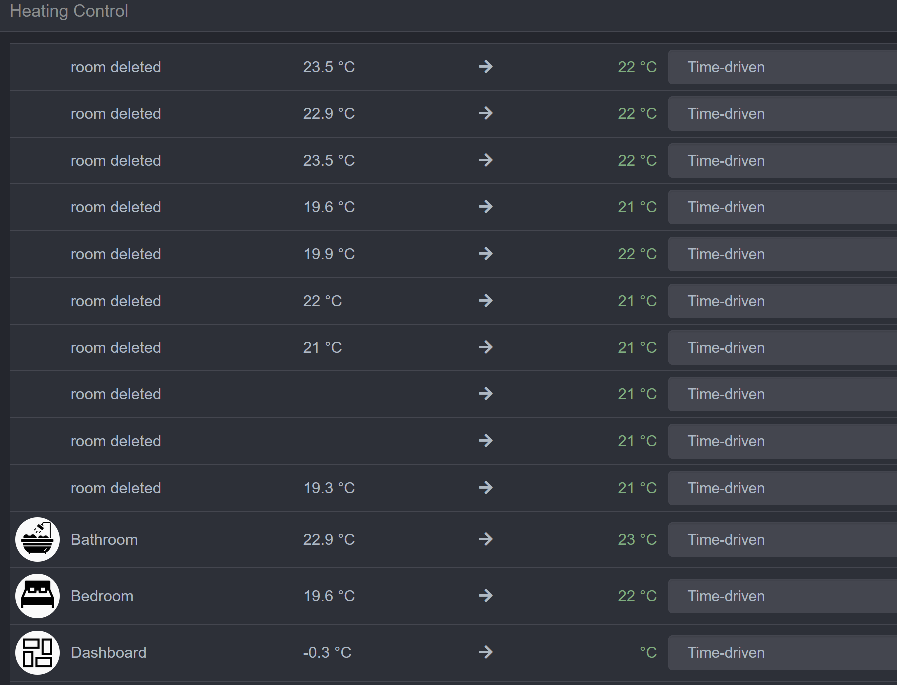

Time driven functionality is still under test, but for now it looks good. The new features are also welcome.
One improvement point would be still nice to get, in the room view:
- deleted rooms should not be displayed
- room without thermostat should also (optionally?) not be displayed
See the attached image for details.
