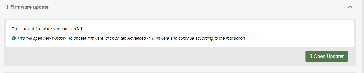

Updating from the GUI also does not work, when I press the button I get my ip adres(of the Rpi) shown and then "refuses to connect"
