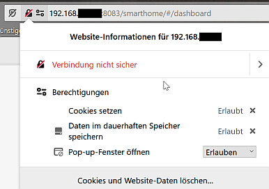

Please see the FireFox site trust context menu (click on the shield in the url bar) -> settings. It states that there is no trust to the site and cookies are deleted on page close. This explains why it is logged out every time.

When I execute nslookup command I recieve a proper answer. My router seems to act as any regular DNS-Server.
If I access Smart Home UI via IP instead of the name it makes no difference. Neither with Firefox nor with Chrome it does remeber me.
In Firefox I even manually gave permissions to set cookies and use permanent memory, it still doesn't work.

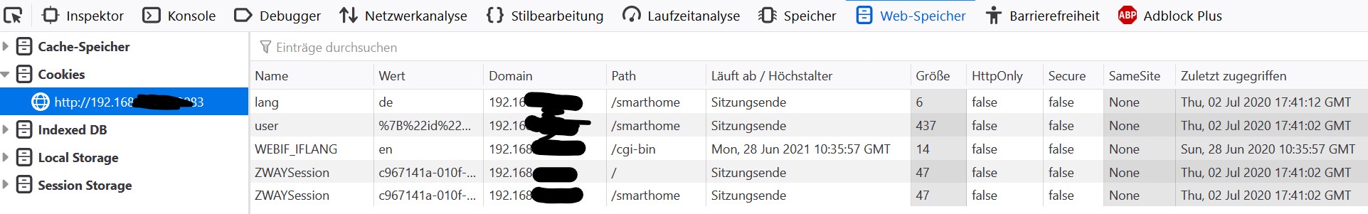

Firefox shows cookies when pressing shift F9. Except of “WEBIF_IFLANG”, whose expiry date is June 2021, cookie lifetime of z-way is only until end of session. It appears to me that lifetime of z-way cookies isn't right.

hm... you are right. After browser restart it will forget the cookie. We will check fix cookies and make their lifetime same as token lifetime.
