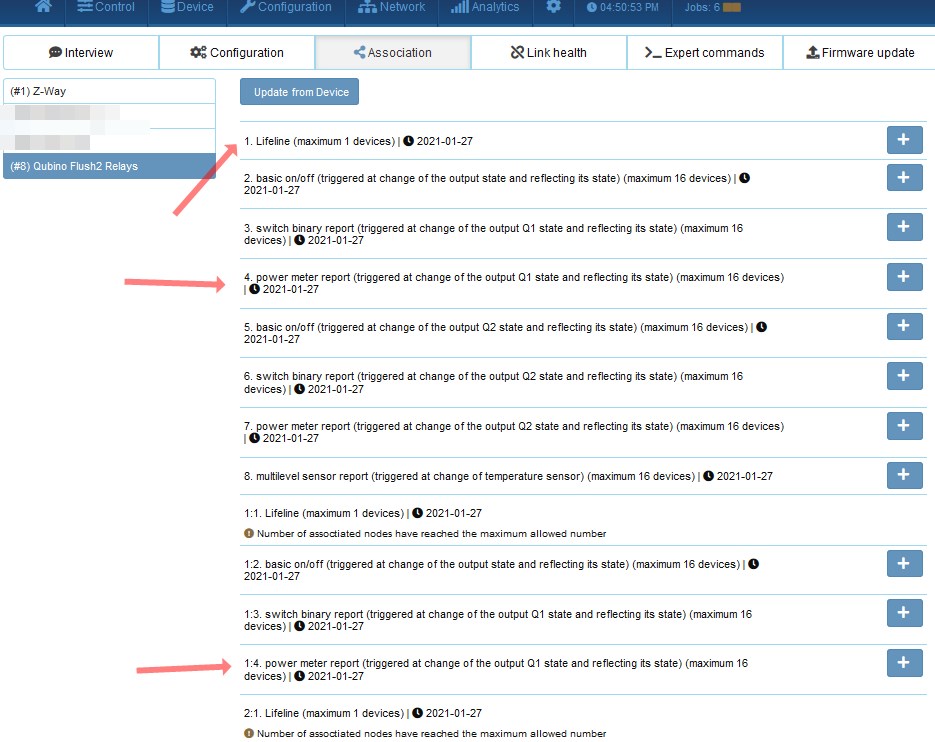

In the Expert view, under Associations it shows Lifeline group 1 is configured to #1.0 Zway
Have you added the association in expert view for power meter too?
Without this it was not working for me.

Sorry, how do i do that? "Have you added the association in expert view for power meter too?"

timb wrote: ↑
30 Jan 2021 15:32
Michael

BTW: interview is complete? And the right device description was selected (at configuration menu in expert view)?
There should be the device image of your relay visible ;)
(Not sure - maybe all options are visible only with full device description, same as for configuration of parameters)

Hey, thanks for all the help, much appreciated.
1. Yes the interview is 100% complete
2. Its a Flush 1 Relay
3. The Association screen is different to your screen shot, showing 9 options, none of which reference power
The good news is that after fiddling with the settings you suggested I can see it in the log file and I can now log W to Influx. Just testing with KWh.
So thanks guys, I seem to have got there!
