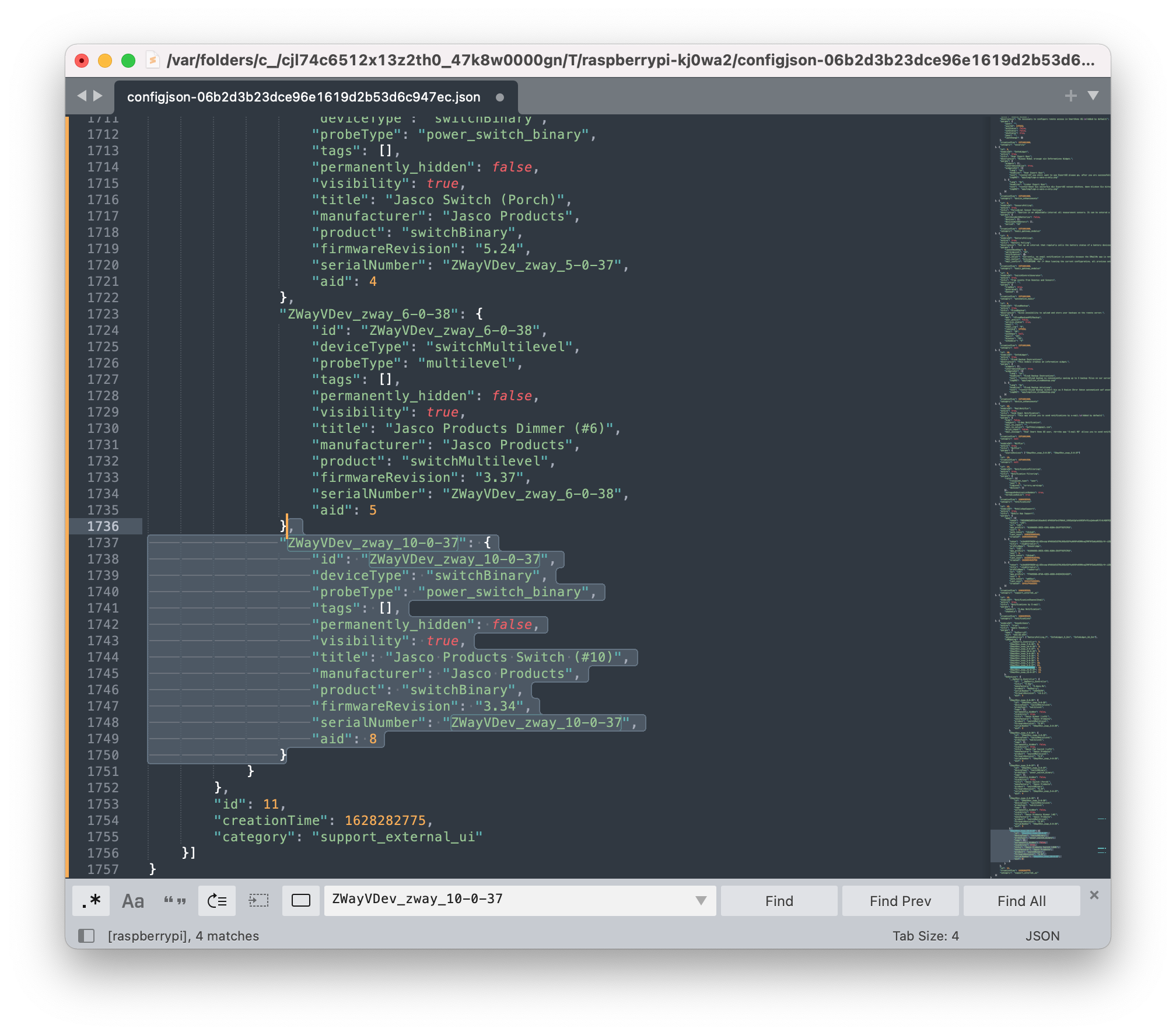

Hi! I found the problem.
I think you stopped HK, then excluded device #10, and then started HK again. So the device left the controller, but not HK. Now to remove the device from HK you need to:
1) Connect to the raspberry pi via ssh
2) Stop z-way-server
sudo /etc/init.d/z-way-server stop
3) Open the file
/opt/z-way-server/automation/storage/configjson-06b2d3b23dce96e1619d2b53d6c947ec.json
4) At the end of file remove block with your excluded device ZWayVDev_zway_10-0-37 (see screenshot)
5) Start z-way-server
sudo /etc/init.d/z-way-server start
In the next version of Z-Way, we will add the feature of removing device from the HomeKitGate application.

Seems like I ran into this issue again, but with a different scenario. Was adding more devices since the fix worked and accidentally excluded a switch that I had just included, so I went about adding it back to the network. But, after I restarted HomeKit gate, almost all the extra devices added fine. But it popped up the same "not supported" when the Home App tried to add the excluded/included switch. What's different this time is the device is still visible & controllable from the Zway server. Was device #15 when accidentally excluded and got included as device #16...

I have noticed that I do have a ton of devices in the vdevInfo section of the JSON file from a previous instance of Zway that would be the same devices that I'm adding to this new instance (after I performed an upgrade & thought I did a factory reset). Would that cause any issues? Also, I'm curious what the HomeKit Gate id mapping is doing. It doesn't seem to be updated with the newly added devices. Is the idMapping supposed to match up with the "aid" under the hkDevices?
