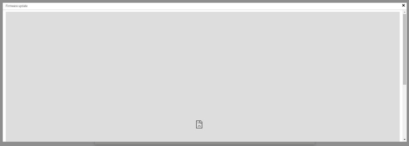

The error remains. No access to the update page.
Raspberry Pi desktop opens any sites (except localhost:8084)

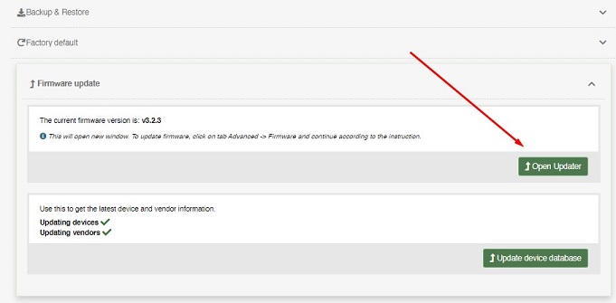

Although the "Open Updater" isn't working, you've successfully updated Z-Way from the command line. Isn't this a moot issue?
If it's any comfort, I always use the command line method for updating Z-Way. The command line approach will clearly show if the wget command has a problem downloading the package and if the dpkg command has a problem installing the package.
If you really have your heart set on using the web UI for updating Z-Way, please understand that there are several potential causes for port 8084 not working (e.g., webif issue, mongoose issue, firewall configuration, port conflict, missing packages). As a starting point, I suggest you first verify you can access your Z-Way instance using find.z-wave.me (i.e., remote access is configured and enabled). Once you have remote access working, I suggest you contact someone at Z-Wave.Me for support since I think remote access will be the quickest way for them to troubleshoot the problem. Please note that this issue may not be a priority for the support team if you're not using the Z-Wave.Me provided raspberry pi image, but you're using an official Raspberry Pi OS image with Z-Way installed via the RaspianInstall script.
