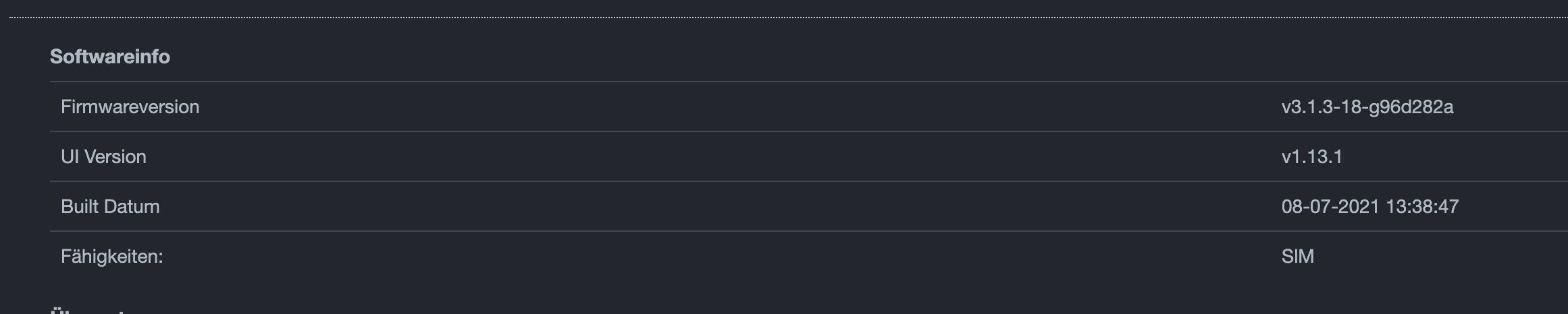

I hope someone can help with my issue connection my z-Wave hub to Homeassistant. I keep getting the error message "no UUID set" when I try to integrate my Z-Wave gatway to HA.
The problem is that my Z-WAVE gatway was provided by a supplier called Rehau re.hub
I do have full access to the webinterface , only thing is I can't ssh into the device.
Here is a screenshot of the installed version

I don't know what to do to fix this problem, but I really hope that somebody here in this community can help.
Like I said, I can access and login to the Webinterface using http://192.168.1.217:8083 and I can also connect remotely. I have added several users and can see the token in the Webinterface which I use to integrate to Homeasstiant, but still get that error.

Hello! Connection to HA is possible starting from 3.2.3 and upper. You should write to Rehau asking them to release a new version. Z-Wave.Me is supporting Rehau with new versions upon request.
ok thanks, so do you think when I send a request to Rehau they would release an update for my hub?
Is it a newer Firmware version I would need Currently (v3.1.3-18-g96d282a) ?
or is it the UI Version I need to update (v1.13.1) ?
I am not sure which one I should request.
Thanks
Re: No valid UUID set
v3.1.3-18-g96d282a should be upgraded at least to v3.2.3. The latest is v4.0.2.
Z-Wave.Me is supporting Rehau upon request, but not sure they will release v4.0.2 fast enough.

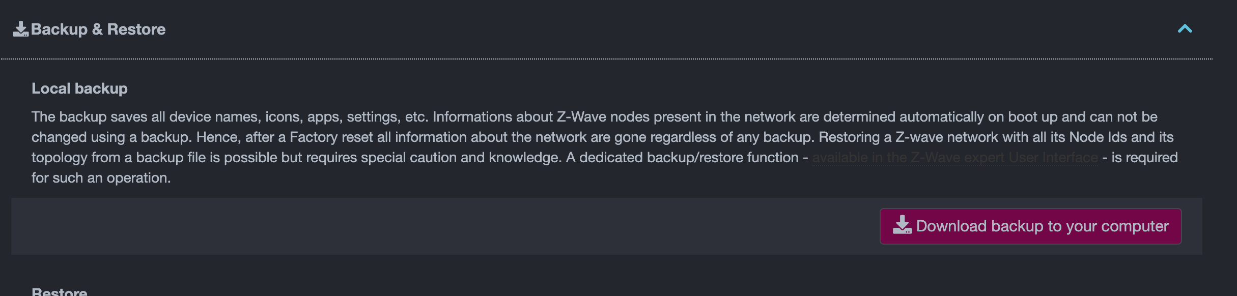

Are you able to perform a backup. The most important one would be for the z-wave controller. If you could get a full system backup, then maybe you could just migrate to say a Raspberry Pi with a Razberry board. If the "last" update from them was 3.1.3 then that should speak volumes about their support of their platform.

Yes I am able to take a backup, but not sure how I should migrate then using a Raspberry image or what to do to get mine upgraded to newer version:
