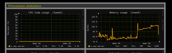

I actually wanted to wait a little longer and do some more tests before reporting my findings. But I'm convinced that I'm right.
The comments about garbage collection in other thread led me in the right direction. I was able to find the app that generates the growth and isolate the reason.
The app is doing socket communications. I made some changes and now I don't have CPU growth anymore in 4.1.2.
I have:
- consistently cleared all buffer variables as soon as they are no longer needed (>undefined)
- deleted a recursive function call with passing a buffer variable
Please look here for the result:
In the left picture, you see there's no CPU load growing.
Interesting is the right picture.It shows the development of the memory of two different versions of the app:
- The last 5 days (week 06) a version without the recursive function call, but also without the explicit clearing of the buffer variables. The memory is growing, but suddenly is comes back.
- The 5 days before (week 05) the version without the recursive function call and now with the explicit clearing of the buffer variables in the app. The memory is constant.
I conclude from this:
- In 4.1.2 there is a problem with the release of buffers received from external. In my case It's socket communication, but this probably also applies to http communication.
- The problem was worsened by the recursive function call. This led to the growth of the CPU load.
As a workaround you can clear all buffers in the app.

As for releasing buffers in the JS code versus letting the GC do it, I see a 20 Mb difference in memory (which is big!), but Z-Way is still handling it by clearing. I'm interested to see which buffer were you playing with to understand why wasn't it cleared on time.

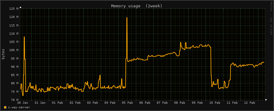

I agree, it looks very strange. And it continues looking strange:
In the meantime, I only made a restart.
