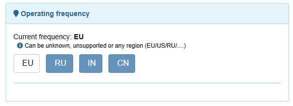

I think Z-Way is the only way to use Windows. Not sure if the Expert interface wouldn't be shown without a license.
Screen Shot 2024-11-01 at 4.55.50 PM.png (47.17 KiB) Viewed 18732 times

Yes it shows me that, but since my stick was originally for EU, it only gives me EU and related options, not US.
