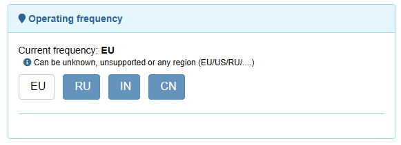

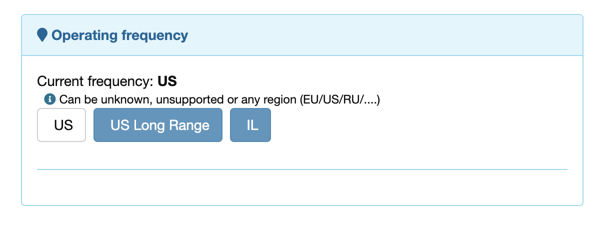

I think Z-Way is the only way to use Windows. Not sure if the Expert interface wouldn't be shown without a license.

Yes it shows me that, but since my stick was originally for EU, it only gives me EU and related options, not US.

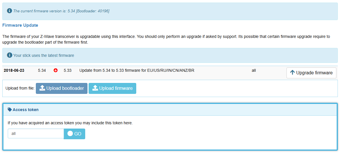

Coming back to the firmware update. I see that my stick is on firmware 5.34. I see from the interactive map that the latest version with the same bootloader is 5.39. I've tried to click on the nodes to get the possible firmware versions, downloaded them and tried to update them via Z-Way Expert UI http://localhost:8083/expert/#/uzb
The problem is that it never succeeds.
Then I saw here https://forum.z-wave.me/viewtopic.php?f ... are#p86965 and I tried to enter the access token `all` to see what possible options are available.
Now it only shows me an option to downgrade from 5.34 to 5.33 (which btw is not anywhere on the interactive map)
Is there any way to upgrade from 5.34 to 5.39?
