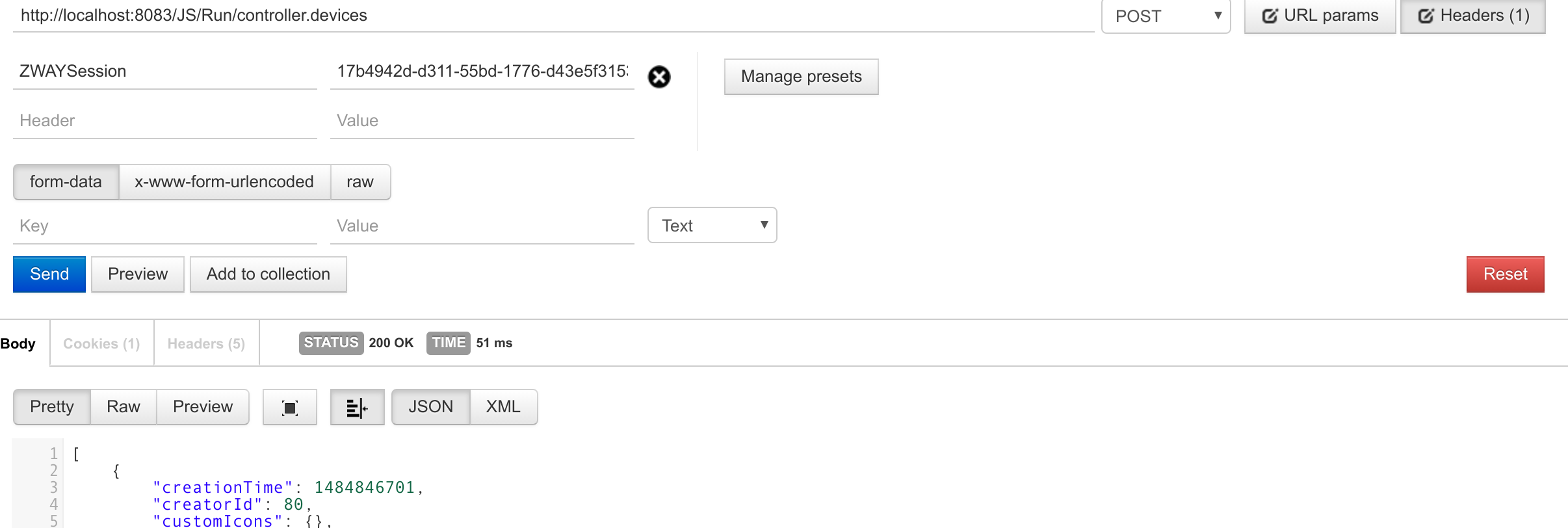

Can you give more info? POST request works for me for /JS/Run. See the image attached.

PoltoS, what tool are you using to run the HTTP requests?
Re: Z-Way 2.2.4 not supporting HTTP POST requests
Posted: 02 Jun 2017 21:03
POSTman - a plugin in Chrome
